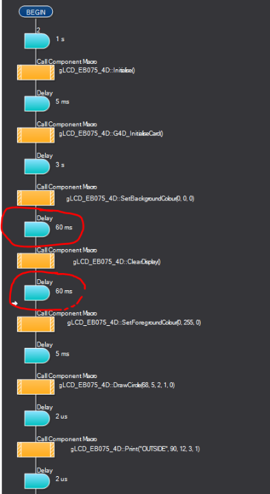

Hello all,
An update.
I added a 2 sec delay between all initialization commands, and now the screen clears and prints only the first command, the "degree circle".
I did check the display data sheet and a responce from the OLED is required before sending the next command.
However, in the Flowcode display library component (EB75) there are no commands to read the messages from the display.
Please advise on what else can be done...
An update.

As promised I did attach the Flowcode 9 logic which works: ECIO40P16 communicates with the "uOLED-128G2" display (Comm speed 9600 baud, F0 set as Tx, F1 set as Rx and D0 set as RESET).
Please note (in the attached screenshot) the 2 timer values, circled in red: if their value is set below 50 ms, the communication fails permanently, does not start at all.

I will try my best, however, I am limited with the measurement hardware...
