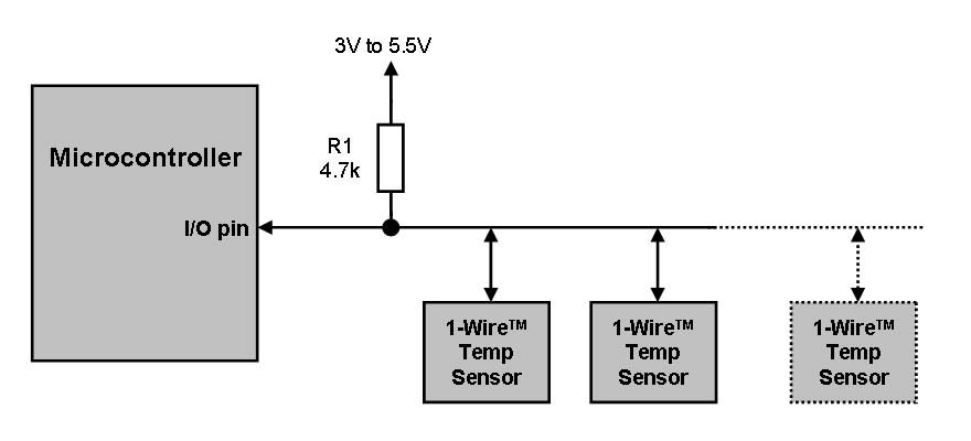

I haven't used OneWire devices, so I checked...
Looks like we do need not to use the diff. pins, but only one.
Please read:
https://www.flowcode.co.uk/wikiv7/index. ... Interface)
Please read:

- ds1820_uc_interface.jpg (41.84 KiB) Viewed 45901 times
Re: Arduino nano, multiple DS18B20 problem
Yes, he know how 1wire works, but he need to read ID of each sensor. If you have 1 sensor on 1port, you don't need ID. If one sensor stop working, you can simply replace with new one.

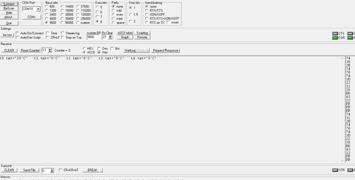

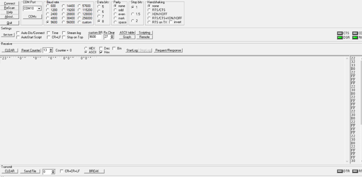

Friend tried same program on Arduino Mega2560. Everything works. Even 7 sensors. Is it possible that nano is not capable of reading more than 5 sensors same time? He send me screenshots. When reading 5 sensors works ok, when connect 6th sensor, strange things happens. Something with rs232 maybe?
- 6sensors.png (160.49 KiB) Viewed 45691 times
- 5sensors.png (173.87 KiB) Viewed 45691 times
