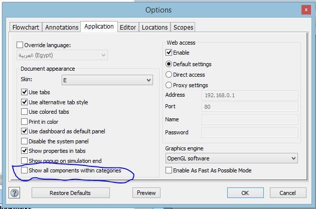

I could not find any I2C Display in v6 and seem to have found a "hidden feature" of FC which I'm glad to say is no longer. In Global Options you need to check a box to see everything in a category.....
Quite why this was the case is beyond me but no doubt a reason at the time. I can only hope I had that ticked when I used v6 or I might have upgraded to v7 needlessly
(v6 only on this machine for historical reasons).

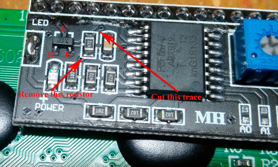

I used different approach. I cut the trace on pcb of i2c backpack, between the PCF8574 and transistor. Remove pull up resistor from base of transistor. On my pcb i added pull down resistor to D6 on arduino and connected wire to base of transistor. Everything working as i want.
- Test backligt.fcfx
- (7.13 KiB) Downloaded 507 times
- backpack.png (1.52 MiB) Viewed 54248 times
