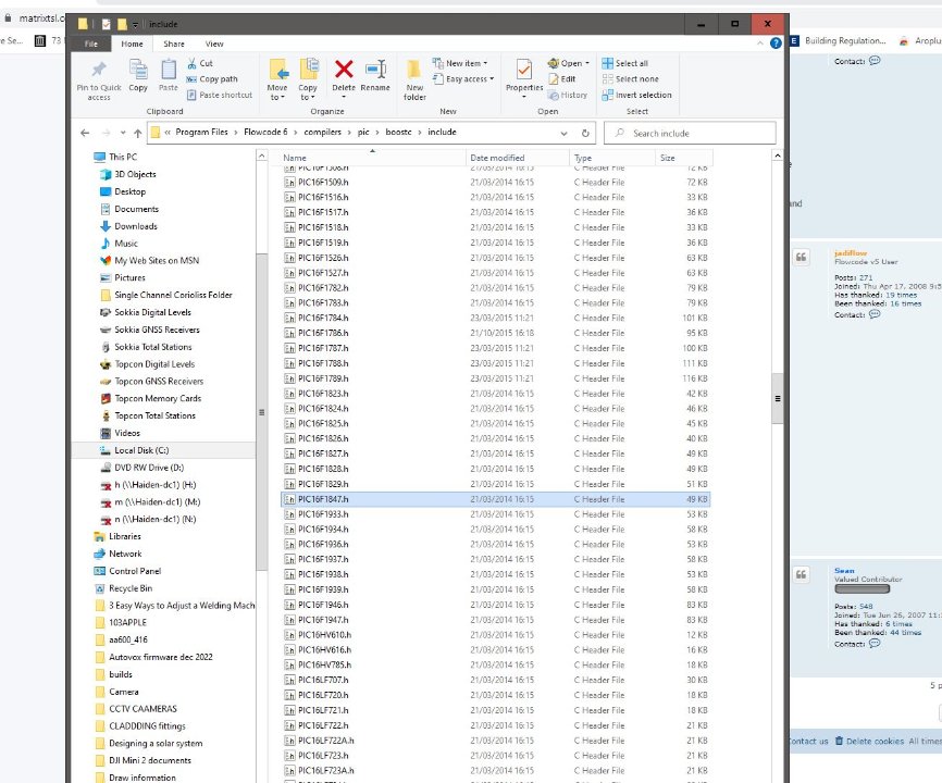

Also checked the pic.c file for the 16F1847, attached in case I had the incorrect description for TMR0 etc but seemed ok?
- Flowcode boostC location.JPG (126.54 KiB) Viewed 22846 times

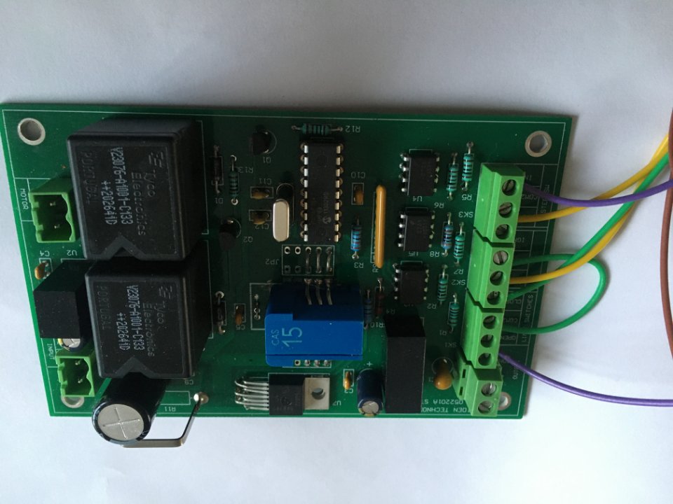

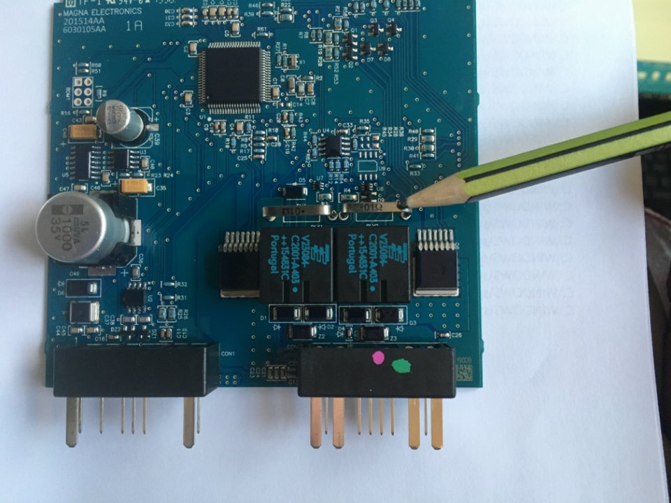

Unfortunatly the Ford controller does not allow manual driving of the step so it was analysed whilst in auto depoly/retract as per the attachments. Following this it was removed and the body control files for the minibus changed to remove the powered step feature. Because the OEM controller was CAN bus it would have flagged an error on the vehicles management sytems and shut down the ignition system.
Using the Ford controller as a basis I have now designed and built my own but using a PIC micro, this is the one I have been using for the manual testing.
I have had a look through the Boost C manual (version 7 pdf in Boost c for flowcode 6) but despite trying various combinations still no luck.
It looks like I will have to use the interupt on RB0 which does work but not what I wanted.

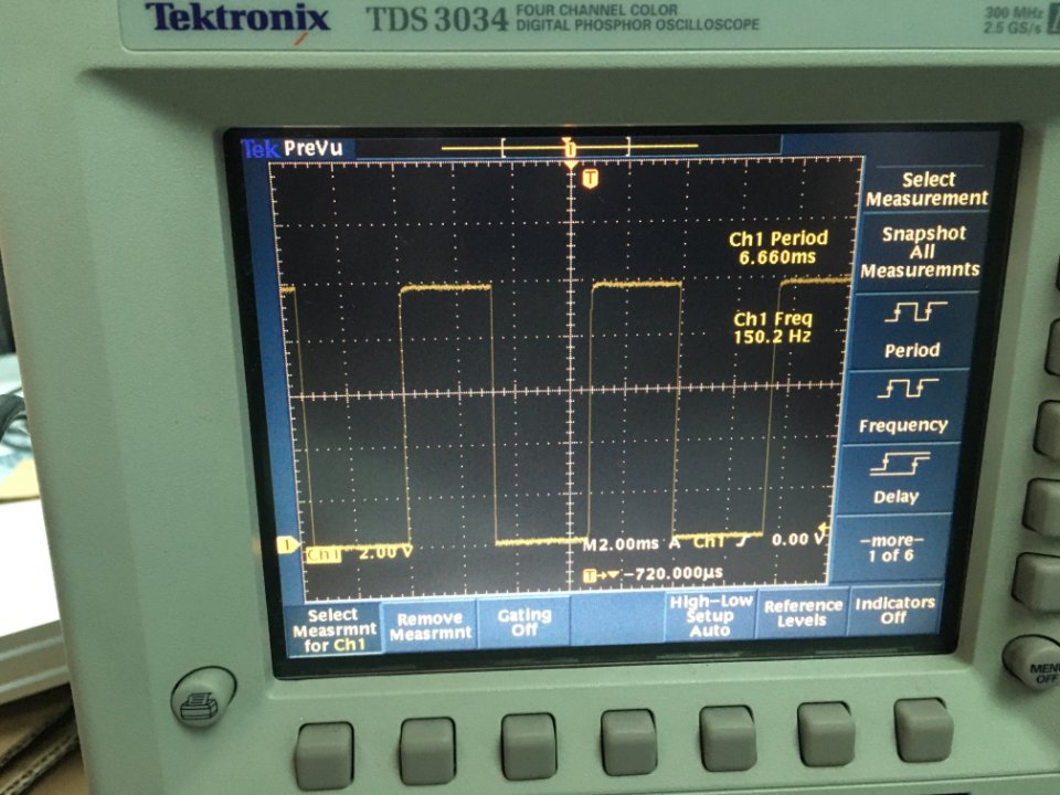

Yes my hardware design (pic attached) has incorporated the facility for both open and closed limit switches. Its unlikly the motor will be running at 9000 RPM probably closer to around 200-400 odd due to the load and being high torque. The hall effect feedback would be from a shaft encoder of some sort, possibly 200 or 360 pulse rev etc.
The issue though is in automotive applications (used to work as electronics design engineer in automotive) we used to have serious reliablity with external switches of any type so assume this was the reason Ford going the route of using encoder feedback alsong with cost and perhaps 'turn key' solution from their supplier for the step.
They also used current sensing though as I mentioned earlier so that would be fine to detect stall/overload. Again my design uses the same approach so 2 methods to detect end of travel although I agree not ideal perhaps.
I have tried a few searches for c code examples on the forum but no luck, any pointers?
I seem to be able to read the timer registers TMR0, TMR1 etc with different results being indicated on port B but think the issue is still trying to set the timer at the begining and also clearing it. Flowcode 6 appears to offer bit set/clear as you have shown me and the version 9 that I have just downloaded on 30 day trial seems to allow both bit operation and complete port, i.e. PORTA etc
Although the int is an option its really bugging me now that I cant get at the timer register!!
