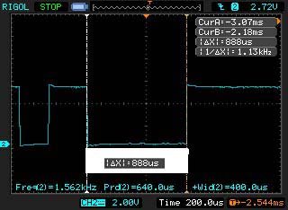

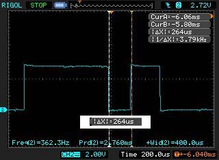

Finally I had a chance to use my scope.
As I have PIR sensors from two different Chinese manufacturers I noticed that even the 1527 protocol used by both companies the length of pulses are different.
Below example for Kerui PIR sensor.
Low Short and Low Long durations are less than the no-brand PIR sensor.

Hi Viktor
Those traces are quite interesting for all the wrong reasons
When I saw the first trace showing a low (part of transmitting a 1, 3xH + 1xL) of 264uS giving a presumed total bit length of 4 x 264 = 1056uS I thought not too bad, however when you look at the preceding High portion you can clearly see it is far more than three times the width of the Low (should be ~792uS for a Low of 264uS).
Your next trace shows a "0" (1xH + 3xL) which should give a Low of around 792 based on your previous trace, but you get 888uS.
I assume that the outputs are consistent, in that you are getting the same results each time, albeit not quite as expected? Of interest, is the total "bit" length the same or does it vary too (time taken to transmit 3H + 1L or 1H + 3L). If results are consistent then you can base around your empirical values and measuring the time from H/L transition until L/H could certainly be one way to capture.
I'm due to receive the remote control tomorrow sometime so quite keen to see what comes out of it.

I can be wrong but I can say that the Timer1 readings are not stable. This is the reason number 1.
Another problem is the amount of 'noise' during transmission and reception. Voltage as well.
Re: consistence of the pulse duration.
I don't think that duration is constant (again -> problem with Timer1, etc).
I noticed the next. I tried to capture the preamble and it wasn't easy as duration was changing after each reset of Nano.
I should add to another problem the steady +5v supply or +7-12v supply to Nano. If power supply is not good the duration will change all the time.
That is why people use the min/max values.
I didn't find time to finish reading the Kerui PIR sensor, but I think the:
1. Low Long duration should be apprx (p_us >= 700 && p_us < 1150)
2. Low Short duration should be apprx (p_us >= 150 && p_us < 350)
Note: the sensors from different manufacturers have different pulse duration.

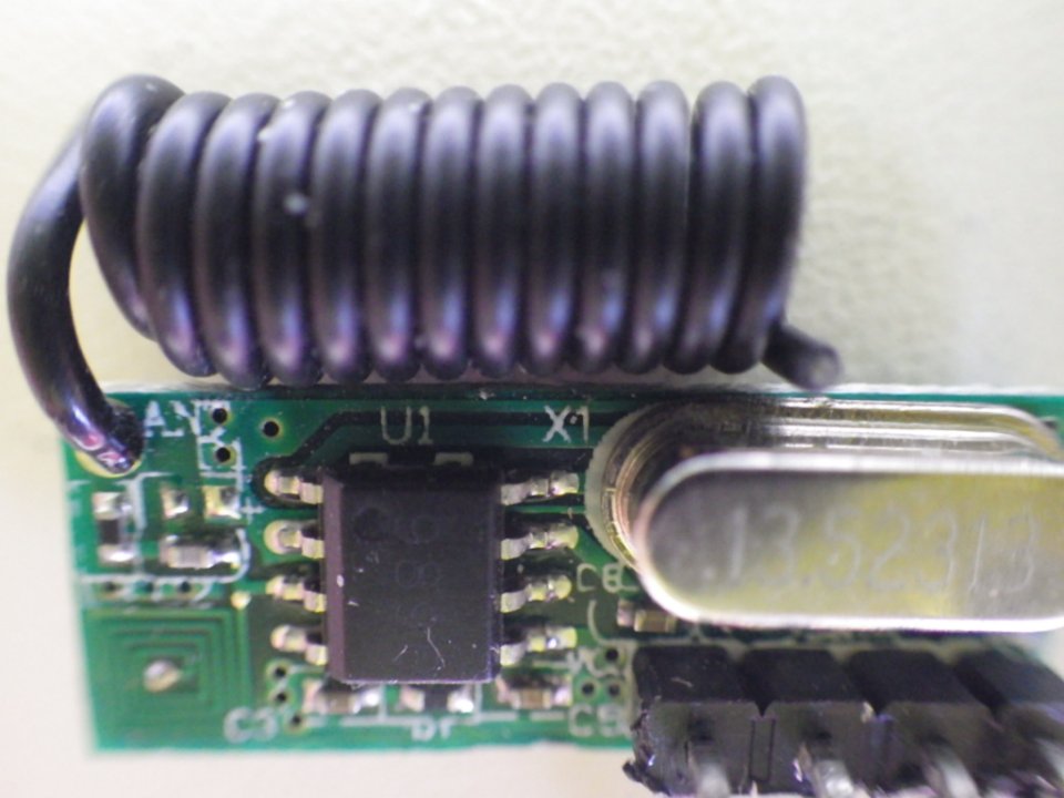

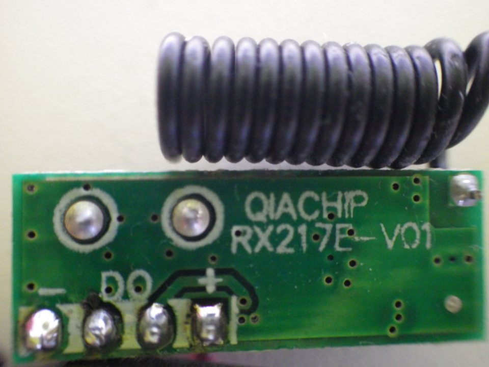

Received my module but only had a brief look so far.
Appears well made but much smaller than expected. Chips are all SMT and eentsy. Looks like they are using custom chips based on protocols too, as the numbers appear to be OEM. The RF section appears to be a very, very small board connected by a few pins marked Positive, Negative and DO (which may be two pins).

Can you please publish a photo of your module?
Is it a Rx only module?

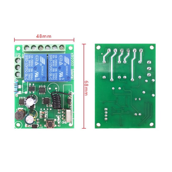

- Posts: 786
- Has thanked: 187 times
- Been thanked: 205 times
Re: HC-12 433 mHz module + Ard + Kerui PIR

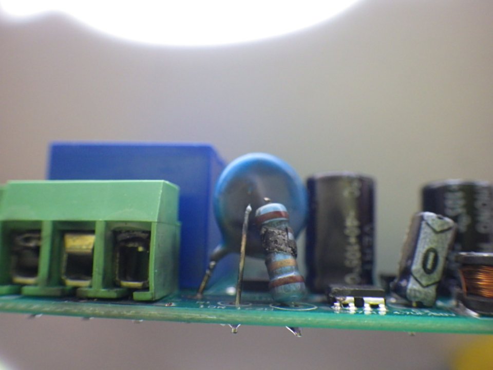

Got any vinegar? As per my moniker the chips are well and truly fried......

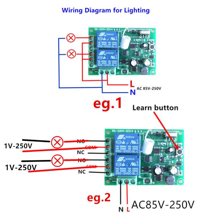

The unit is from Qiachip (https://qiachip.com/) and is a two channel 220v controller https://qiachip.com/collections/ac-powe ... els-module

In a lapse of sanity I accidentally shorted out part of the board.... Cat wasn't best pleased with the bang
I then removed what appeared to be the RF unit which is marked RX217E and had +ve / -ve / DO markings on pins. The only chip was I assume OEM, marked 9080. Connecting DC across the terminals with a scope on DO showed a flat trace so I'm guessing I made a good job of destroying things.
Another on order.....
I am, or was going to use it to control a roller shutter.....

Accidents... What can you do...
Can you please have a look at the Rx module chip?
I tried to find out on the web-site, but failed.
Is it SYN470R?
Is it SYN470R?

The board (KR2202) came as a complete control unit based on 1527 and appeared to have a small RF module attached at top right. After I blew it to bits I removed the RF module in the hope it could be recovered. The 90 degree headers were solidly jammed into the PCB holes then soldered (holes are probably a drill size too small). Freeing the module took considerable physical effort and it could have sustained damage in my doing so.
There is a single chip marked 9890, a crystal with the odd discrete or two. Unfortunately I don't know what the board outputs, RF or digital but I suspect it isn't RF.
The main board has a couple of chips which appear to be the brains of the unit marked (I think) FMD B2J4RKE and LK22221. Unfortunately I can't find any information for any of them. However the RF DO pin connects to Pin-2 of the FMD B2J4RKE so I guess it is doing decoding.
Kaboom
When I get the replacement controller I might gingerly have another poke..
EDIT...
New controller arrived and the DO output on the RF board is digital, therefore all RF processing is handled in the module by the 9890 chip. Output is high until it receives a transmission. I might connect a hand held scope if I get time, as I'm a bit wary of connecting anything that's actually grounded to this.
Kaboom
EDIT...

Re: There is a single chip marked 9890, a crystal with the odd discrete or two.
I think it is a decoder chip. Probably not 9890, but 9896.
Re: Unfortunately I don't know what the board outputs, RF or digital but I suspect it isn't RF.

Tx, Rx kit
I think you have two Rx modules.
One Rx module has two relays ( the one you need to control an AC motor).
You need another module -> the Tx module (button).
RF is an umbrella word.
RF covers all possible frequencies and modulations.
For 433.92 mHz (no licence freq) people use something like the Morse code system by changing the carrier as:
Amplitude Shift Keying or ASK.
On or 1 = RF is max
Off or 0 = RF is none
In Amplitude Shift Modulation the amplitude (i.e. the level) of the carrier wave is changed in response to the incoming data signal. This is sometimes called Binary Amplitude Shift Modulation as there really are only two levels to be concerned with:
Tx, Rx kit

My little Velleman scope, is to be fair very basic indeed, and I bought it precisely due to its compact size and lasting a while on a charge. It was bought to connect with a current clamp so I could "see" inside a cable and did the job very well indeed (I was looking for random transient inductions).
I connected it to the RF DO terminal and can confirm that in the presence of a transmission from any Tx unit whether paired or not, it outputs a clearly defined square wave along the lines of what's expected.
I didn't have time to measure any parameter before it died though. It's now on charge alongside a Tektronix so hopefully tomorrow I'll be able to capture.

Measuring the Low durations
I am going in this directions as RxB12 on board chip (SYN470R) 'goes' into high level due to AGC has no signal. A lot of 'pulse-like-noise' generated out of AGC.
I can see on my scope that (after first packet arrived) -> it is corrupted.
I do beleive that I need only a few days to finish with decoding 1527 protocol. Will do it soon.
