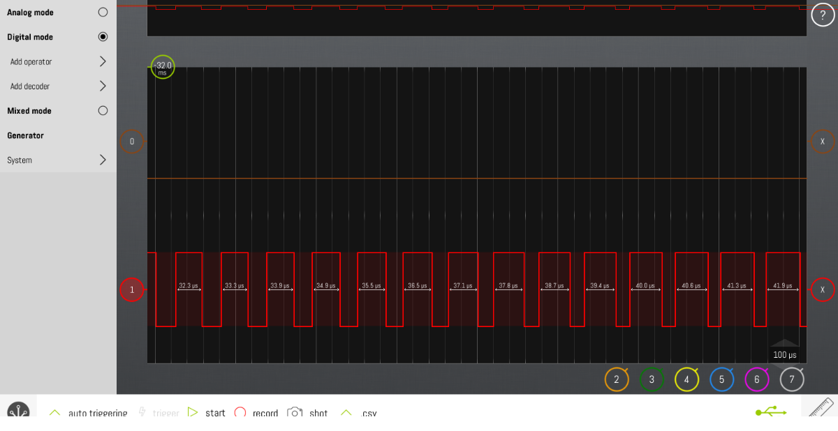

Okay - so a first attempt which seems to work okay..
Unfortunately the C is written in 'write only' or 'write once' style (no comments) - so I haven't tried to decipher the register writes. This is left as an exercise. It would possibly be okay just to use a standard FC timer interrupt setup - but I've used the code as is and set as a custom interrupt..
As mentioned - the C has a bug - I've replaced the recursive calls to Inverter with gotos (so now I have to go and scrub my hands again :| )
It's written and tested using v9 (I don't have FC8 installed at present and our broadband is slooowwww at the moment - estimated time 4h for the download)
I also used a Nano as one was to hand - you'll need to change the target...
The C also sets the 'volume' in the interrupt handler - which I would probably try and 'move' into the Inverter loop.. I think I set an initial volume - instead of the 0 the C has... (change this back to 0 - but volvalue is only read after 140 'waves' and having it the interrupt handler will cause a 'glitch' in the waveform) The 'test' in the C should be >=175 not > 175 in the ISR..
Button on pin12 toggles the output on and off... I used a jumper to a 470 resistor to gnd and 'touched' the wire on. The resistor doubled as the current limiting resistor for the LED on pin2
PWM Inverter.fcfx
(26.22 KiB) Downloaded 442 times
Here with the 'setvolume' code 'disabled'..
A snippet of the waveform - notice that the pulse is slightly longer each time.
