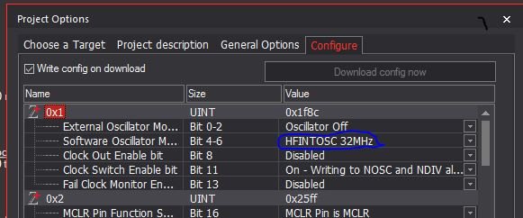

Re: PIC16F15354 - Non-working I2C & 24C16 Macros
Thanks for your reply.
The C code is not needed as the clock is configured in Project Options > Configure Window. I have attached a screenshot for your reference.
I have added a 1Hz flasher before the start of the EEPROM communication, to confirm the working of the oscillator & the flasher works fine. The file is attached.
Regards,
Sanjay
Regards,
Sanjay
With the flasher was you using your eye to judge or a scope/logic analyzer?Sanjay Singh wrote: ↑Tue Mar 21, 2023 7:20 amI have added a 1Hz flasher before the start of the EEPROM communication, to confirm the working of the oscillator & the flasher works fine.
This is not trueSanjay Singh wrote: ↑Tue Mar 21, 2023 7:20 amThe C code is not needed as the clock is configured in Project Options > Configure Window. I have attached a screenshot for your reference.
The reason is at power on the default speed with 32MHz selected is 16MHz
That is because the 32MHz is being divided down.
To run at 32MHz you will need the C code block as Chipfryer27 mentioned even though you have changed your target device.
Just place a C code black at the start of main with
OSCFRQ = 0x06;Martin
