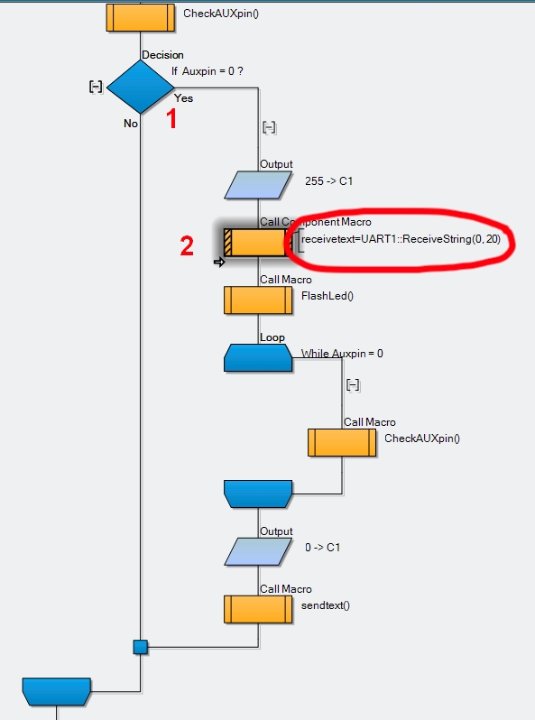

But now I have another issue:
In this example I wait until the AUXpin variable goes low and then try to receive a string via UART1.
I see via my logic analyser that there is text received, but not stored into the variable "receivetext".
When the AUX pin goes low, the transfer of data is held for a few microseconds.
The module I"m working with holds this to give the microcontroller the time to wake up.
The time between the AUXpin going low and the sending of the data is about 5ms (datasheet).
But which confuses me all the time is the waiting time in the Flowcode UART component.
I tried several settings (from 0 to 255), but strangely the variable "receivetext" is empty all the time.
How can I make sure the data that comes from the module gets into the variable "receivetext"?
Thanks!

I would strongly be tempted to use the RxInt Interrupt feature when capturing data. That way you ensure the uC will be ready to process when data is actually received at the UART.
If you also couple this with the Circular Buffer you are free to process your incoming stream whenever you wish. There are a few examples kicking around that are very helpful.
Enable RxInt to call your Receive_Macro (or whatever you wish to call it)
In the Macro use UART:ReceiveChar or ReceiveString to capture the data depending on your needs.
You could then put this in the Circular Buffer for processing whenever.
Another option is to have a loop inside the macro, exiting when ReceiveChar times out. In the loop, capture the data per byte and then store in the CB. I used this approach in a previous project with little issue. From the Main program I "polled" the CB to look for the presence of my data and if found processed.
