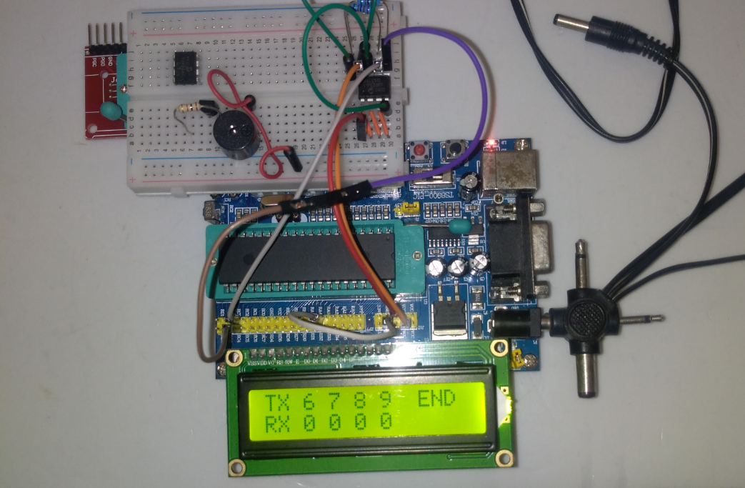

Last time I tried, it took a few attempts to display the correct information.
It was on a separate bread board to microcontroller, so could have been caused by stray capacitance, or as Jac has been saying flowchart is not correct?
Hope this helps

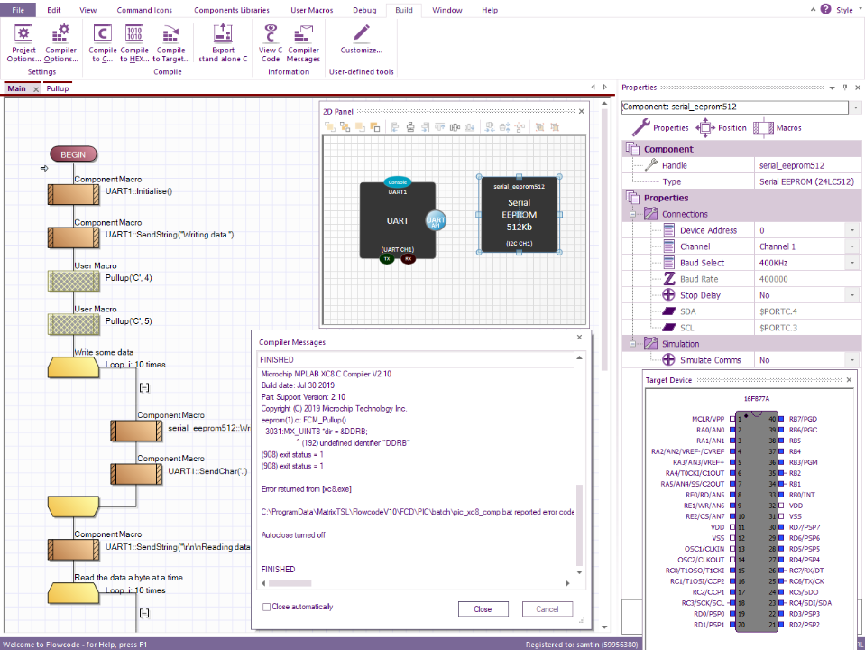

Hi Martin
I did the porting on the PIC16F877A, without any modification, but it does not compile, I am attaching the image. What should I do? I am using Flowcode 10.
does not compile.png (276.01 KiB) Viewed 17693 times

You'll need to change the i2c pins (and the eeprom address) in the component properties.
Also delete the macro pullup (and the two calls to it). You'll need to have pull-up resistors as per i2c.

It does not compile, the same message as the picture above. Please help me to compile.

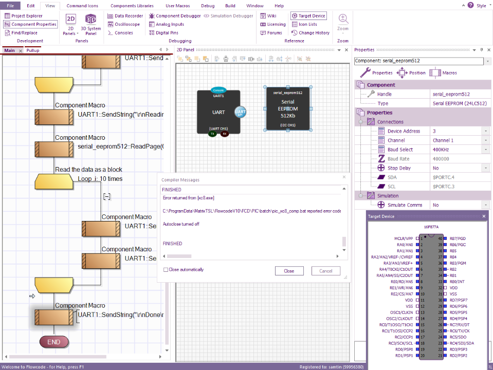

This is the Flowcode message in the image below.
does not compile 2.png (278.3 KiB) Viewed 17674 times

Delete the pullup macro too...
I also output the data to UART - change this to use your display instead ..

Just tried compiling and seems the PIC you have has too little RAM to use the component.
I stripped everything out - apart from Read and Write of 10 bytes (no display etc) - and get an error insufficient memory to allocate _FCL_BUFF (130 bytes) - which would (space permitting) be used by the Page Read and Write functions.
Options:
1) Use a PIC with more memory.
2) Modify the component - remove the 'page' functions and create a new 'cut-down' component. MatrixTSL now kindly supply all the source code for the components.
3) Use my code from the above link - this did have 'block' read and write functions, but relied on the space from the 'caller'
4) Depending on how much data you want to save - use the PICs internal eeprom (the PIC has 256 bytes available)
Looking at the data sheet - the MCU you are using should have 368 bytes of RAM - so I'm a little surprised it doesn't allow this to work, so some memory being used by i2c buffers?
