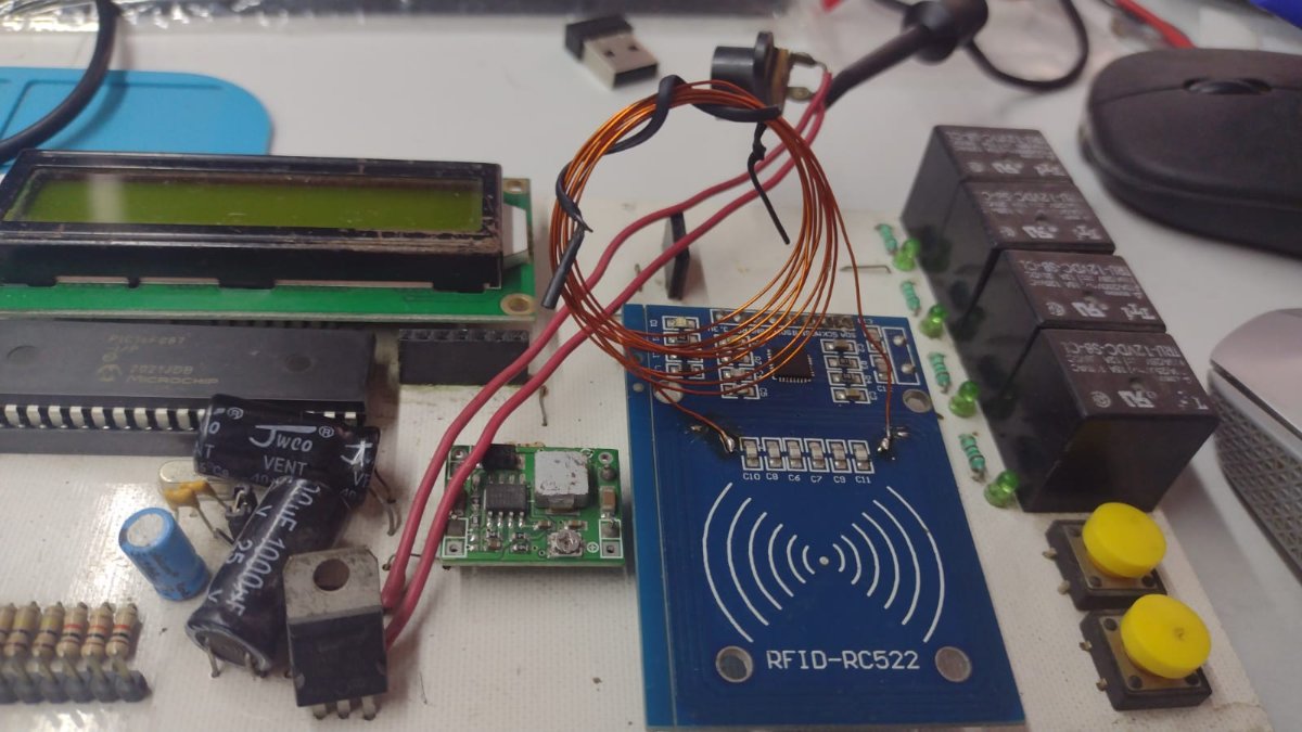

Hello everyone, I would appreciate if someone could help me :)
I'm making a TAG reader with the RFid MFRC522, it works excellent, but I need the TAG to be able to be detected at about 20 cm from the reader, I've tried with different windings and lengths of enameled wire of thin and very thin gauge, different diameters but it continues to detect the TAG when it is 1 cm from the antenna, does anyone have an idea to help me so that the TAG can be detected at 20 cm :?:
Best Regards
Enrique

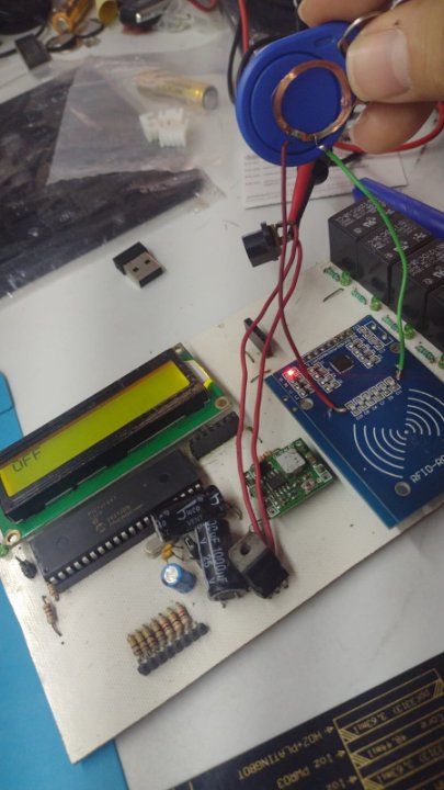

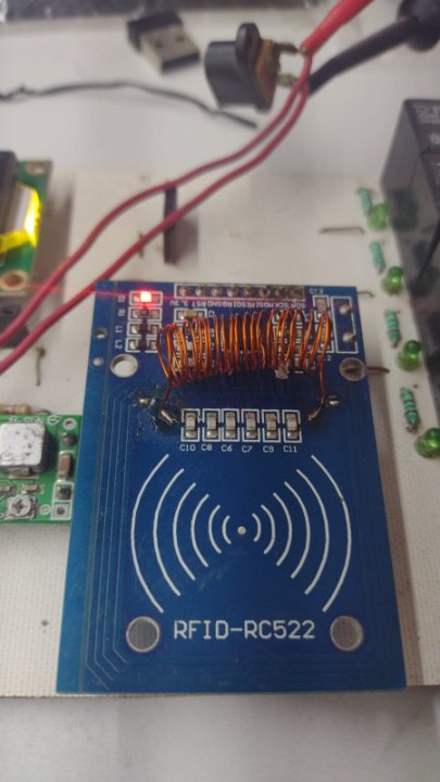

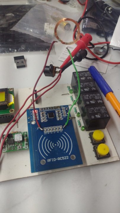

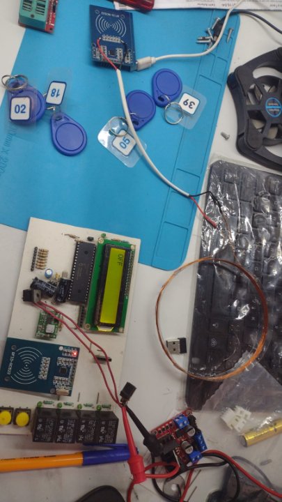

More variants, I have isolated the original antenna from the reader.
50 cm
50 cm
100 cm
100 cm
