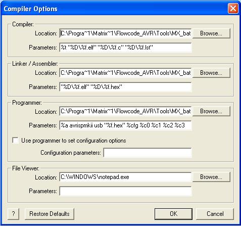

I have now been able to replicate the latest problem, but only when the compiler file path is replaced with the parameter list information information.
The Chip -> Compiler Options window should look something like this (with the shortened path names from a previous post):
(Note: The location strings extend beyond the end of the text boxes.)
Can you confirm that this is the case, and that this still causes the compilation error?

vΓ©rifiez que l'emplacements et les options du compilateur sont correctes.
I confirm that the two cases causes the same compilation error.
C:\Progra~1\Matrix~1\Flowcode_AVR\Tools\MX_bats\avra.bat
C:\Progra~1\Matrix~1\Flowcode_AVR\Tools\MX_bats\avrb.bat
C:\Progra~1\Matrix~1\Flowcode_AVR\Tools\MX_bats\avrc.bat
C:\Program Files\Matrix~1\Flowcode_AVR\Tools\MX_bats\avra.bat
C:\Program Files\Matrix~1\Flowcode_AVR\Tools\MX_bats\avrb.bat
C:\Program Files\Matrix~1\Flowcode_AVR\Tools\MX_bats\avrc.bat
compilation error:
impossible de compiler le fichier .c avec atmega32 "f:\aa\flowcode1.elf ............
