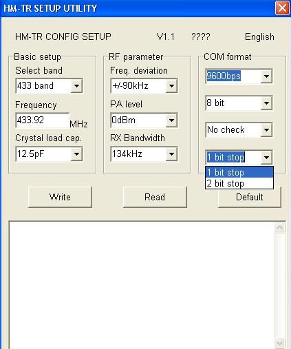

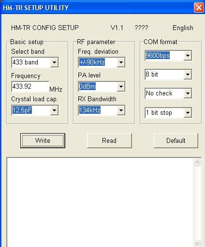

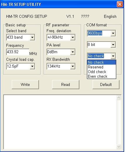

I am getting the new tranceivers 433Mhz and it seems that they are configurable via software. i am sending you a screenshot and if you can please take a look and see if maybe this is not compatible with the PIC we use e.x 16F877A and with flowcode component RS232?
Thank you in advance,
Best Regards
Achillis

Re: Problems Communicating 2 PICs via Transmitter/receiver
Hello Achillis
Sorry for the delay in replying its very hectic around here at the moment.
Yes the device looks compatible,
Your settings look good too. Eg 8-bit data, No parity check bit, 1 stop bit.
I will go over the rest of your questions when I get some time to sit and think about it (hopefully later on today).

I have received the HM-TR-TTL tranceivers and connected them with two of my PICs. The "sending" PIC has the switch board and "receiving " PIC the LED board. When I press one of the switches's buttons I can see a red LED blinking indicating that the tranceiver sends, one the other hand, one the receiving side, the other tranceiver has a green LEd blinking indicating that is receiving data succesfully.
The problem now is that I have to keep pressing the buttons for more then 3 seconds or rapidly push and release them, in order for the "receiving" PIC to display the corresponding value on the LEDs!!! The big problem is with value (1), less for the value(2) and almost with no delay the value(3)!
PICs and tranceiver work with the same configuration>> NO CHECK/1 BIT STOP/9600 BAUD RATE.
I have contact the company from which I got the tranceivers, I sent 3 e-mail regarding this but unfortunatly-I think-due of luck of communication(they are chinese and their English are not to good!) they cannot help me!!!
Do you have any idea what might goes wrong?
Thank you,
Best Regards,
Achillis.
