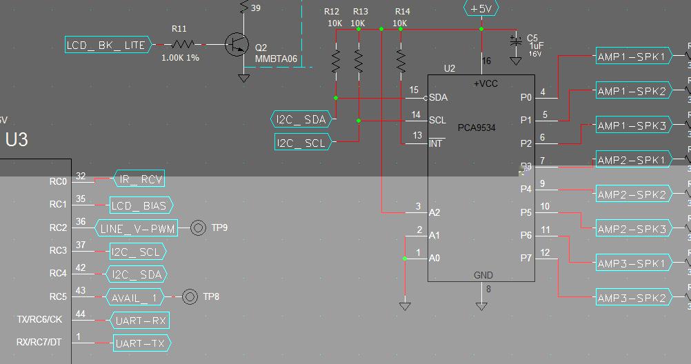

The picture attached only shows a portion of the schematic, the second port expander hardware address is 110.

Here's a portion of the schematic:
I2C controlled port expansion
