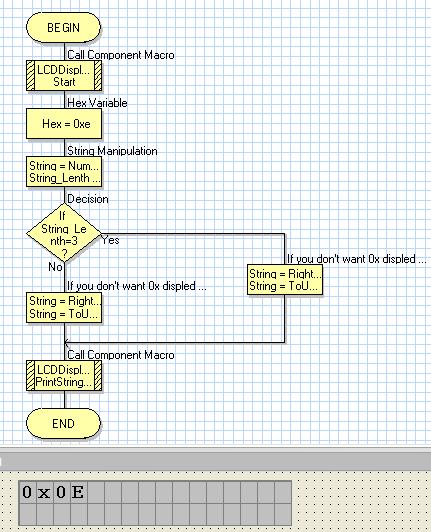

I have created 1 method for you. This way you can choose if you want 0x to be displayed or not.
I'm sure Ben Or Steve will know a better method. Until then at least there is a working version!
You could use this routing as a separate macro.

You should be able to detect if the number is less then 16 using a decision icon. This will tell you if there is only one character or two characters in the number. If there is only one character then you can print out an extra 0 before printing out your number allowing for every number to be at least 2 characters.

Medelecs example is pretty nice and it simulates. My fix unfortunatley does not simulate but your compiled code should not display the single character hex number anymore.

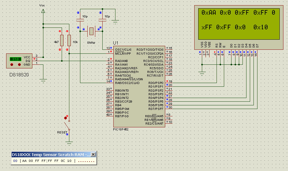

This is the flowcode program: It reads the scratchpad from the DS18S20 temperature sensor and uses the function NumberToHex$() to show the data in hex on the lcd. Because Flowcode does not simulates the onewire component, there are no real data shown. Therefore I run it on Proteus, the first time with the original internal.h As you can see, the real data from the scrathpad are AA 00 FF FF FF FF 0C 10
You can also see what NumToHex is making of it on the lcd. The leading zero's are suppressed but the data is correct.

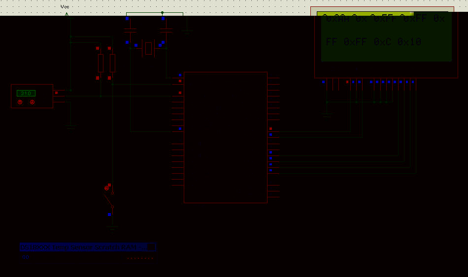

Now with the new internal.h: You can see that the data is not correct ( 0C is shown as 0 ) , the 0X is still in front of each byte and leading zero's are not correctly shown.
I can understand that this is not a high priority issue ( I can circumvent it with the solution from Medelec ( thx ) but I would highly appreciate if NumToHex would convert a decimal number into hex with leading zero's and no 0x in front of it. Just plain AA 00 FF FF FF FF 0C 10.
