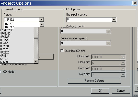

6) The same is valid for the Project options. Selecting a PIC18F452 from the unsorted list of PIC's will keep you busy for a while.

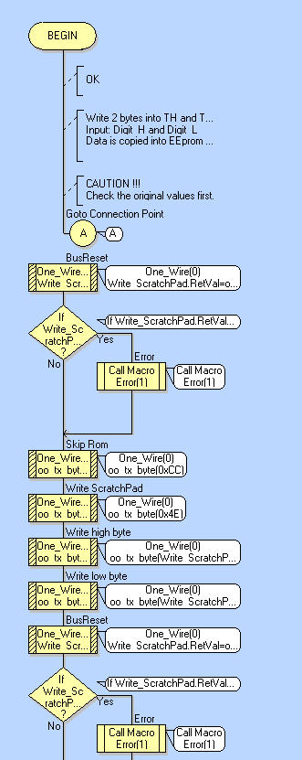

9) Something about printing. Flowcode has been positioned as THE tool for commenting and learning C code.
I always wondered why all comment fields are so truncated that they become in fact useless. Inside makro's you don't see anything. The annotation fields improved a little, but are still insufficient. Even printing the flowchart doesn't solves it. You need to write a lot of comments manually on the printout to make the flow understandable for someone else. I don't think this is the intention? Please expand the comment fields to cover the whole page.
10) This is a suggestion: Why not allowing a "REM" situation. During testing, it often happens that I want to rem-out some icons. Now I need to insert jump-to icons to jump over these instructions. Right-clicking on the icon and to assign them out temporarily ( giving them a blue color) would solve this much more elegantly.

This list is actually sorted, but it is sorted in alphabetic order (PIC18F452 comes between PIC18F4515 and PIC18F4520).Eric wrote:6) The same is valid for the Project options. Selecting a PIC18F452 from the unsorted list of PIC's will keep you busy for a while.

The "annotations" should solve this for you. Why are they insufficient?Eric wrote:9) Something about printing. Flowcode has been positioned as THE tool for commenting and learning C code.
Good idea.Eric wrote:10) This is a suggestion: Why not allowing a "REM" situation. During testing, it often happens that I want to rem-out some icons. Now I need to insert jump-to icons to jump over these instructions. Right-clicking on the icon and to assign them out temporarily ( giving them a blue color) would solve this much more elegantly.

About 6: I give you an example: this doesn't look sorted to me.
About 9: I mostly program with a small main and several makro's. Variables in a makro are written as: name of makro + name of variable and this is often longer than what the annotationfield allowes.
If I show you this, can you find out what the program is about? I always comment the steps in very short phrases, but to inform somebody else, I should be able to comment more.
Of course you could zoom in to 100% to see more, this sometimes helps, but then you must always zoom back to 75% to keep the overview.

Re 6: That's so wierd - the list is sorted on all PCs I have seen.

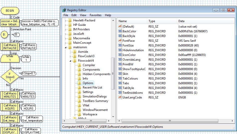

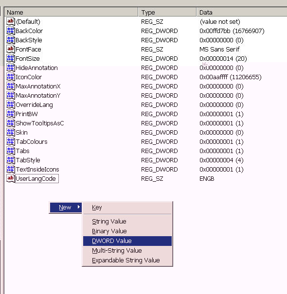

Re 9: There are undocumented registry entries that control the maximum width/height of the annotation field. These are in the following location of the registry:
They are both "DWORD" values and are "MaxAnnotationX" and "MaxAnnotationY". They default to 475 and 300 respectively. Setting either to zero will remove this maximum size restriction (and allow the full annotation to always be shown).
HKEY_CURRENT_USER\Software\MatrixMM\FlowcodeV4\Options-

Steve thank you for sharing that information. It's details like that are really useful to know.steve wrote: Re 9: There are undocumented registry entries that control the maximum width/height of the annotation field. These are in the following location of the registry:They are both "DWORD" values and are "MaxAnnotationX" and "MaxAnnotationY". They default to 475 and 300 respectively. Setting either to zero will remove this maximum size restriction (and allow the full annotation to always be shown).Code: Select all
However ( there is usually 1 however :p) On my PC those two options are not available

Hello
The same at my pc.
The same at my pc.

ah. Thanks Eric. I thought they were suppose to be added when installed V4.1.
