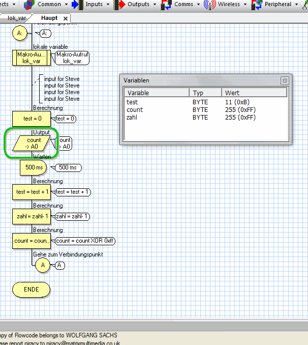

Re: ICD Mode part 2
Hello Steve
I want set in my code the Globale variable test to 0 , bat the variable dont schange to 0 he remain by 11!
I put in test = 0 second bat he hold the 11 alltime in ICD-mode.
Regards Wolfgang
Regards Wolfgang
- (52.71 KiB) Downloaded 2810 times
- test = 0.gif (30.01 KiB) Viewed 9423 times

Re: ICD Mode part 2
Hello Steve
If i rename the "lokale variable to lok_var.test_1" it works.
I cannot have the thame names like: global >> test ...... lokal >> lok_var.test ????
Regards Wolfgang
Regards Wolfgang

- Steve
- Posts: 3434
- Has thanked: 114 times
- Been thanked: 422 times
Re: ICD Mode part 2
Yes - I now see the cause of the problem. This will be fixed in release v4.2 of Flowcode.
The workaround for now is to ensure that the local variables have a different name to the global variables.
