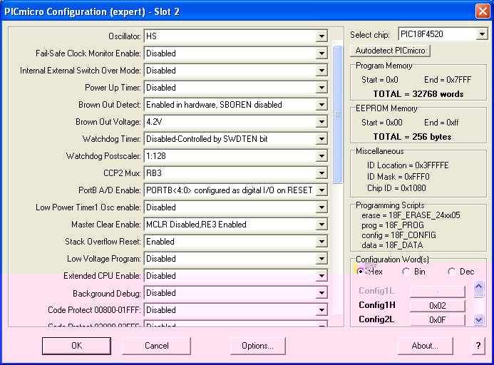

My guess is that this is a configuration problem, a baud or a clock speed problem.
Setting the chip configuration to something similar to the following should help to get you up and running. Please note that all settings that are not shown are set to disabled unless you specifically want to enable the write protection etc.
Also check that the clock speed is set correctly in the Project Options window to allow the baud rate to be calculated correctly. Once you have done this you may also have to go into the RS232 component properties and click OK to allow the new baud rate to be calculated correctly.
