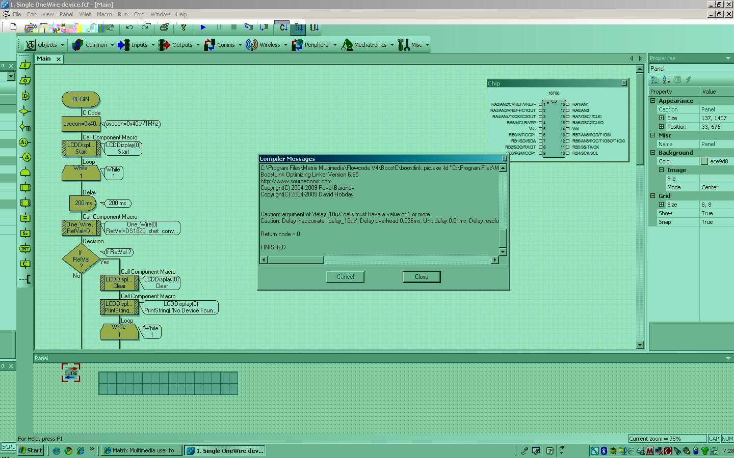

Ben,
Sent an earlier post but not sure it posted
Additionally Im getting a delay problem with your code when I try to build the download file
Please see attachment
Really would like to get this one working
Thanks,
George

Re: One Wire Example - Failure on linking
Hello
The message you showed in your screen shot is meerly saying that at your clock speed of 1MHz the closest the 10us delay can come is 36us. This should be fine and shouldn't cause any problems.

Upon review of the OneWire specification, it looks like the V4 macro for One Wire does not give the user access to all the required functions to get OneWire to work. If I review the C code from the OneWire DS1820 Example you sent me it has all the proper defines, but again, but some of the key ones are not in the UI popup for the OneWire Macro.
C Code from the example:
char oo_scratchpad[9];
// Scratchpad contents
// 0 Temperature LSB
// 1 Temperature MSB
// 2 Hi alarm temperature
// 3 Lo alarm temperature
// 4 Reserved, 0xFF
// 5 Reserved, 0xFF
// 6 Remainder register
// 7 Nr of counts per degree
// 8 CRC of pad contents
// Commands for the OO
// 1. ROM function commands
#define OO_READROM 0x33
#define OO_MATCHROM 0x55
#define OO_SKIPROM 0xCC
#define OO_SEARCHROM 0xF0
#define OO_ALARMSEARCH 0xEC
// 2. Memory Command Functions
#define OO_WRITEPAD 0x4E
#define OO_READPAD 0xBE
#define OO_COPYPAD 0x48
#define OO_CONVERTT 0x44
#define OO_RECALLE2 0xB8
#define OO_READSUPPLY 0xB4
MAXIM states that the following functions must be called in the correct order or the DS18s20 will not function
TRANSACTION SEQUENCE
The transaction sequence for accessing the DS18S20 is as follows:
Step 1. Initialization
Step 2. ROM Command (followed by any required data exchange)
Step 3. DS18S20 Function Command (followed by any required data exchange)
It is very important to follow this sequence every time the DS18S20 is accessed, as the DS18S20 will not
respond if any steps in the sequence are missing or out of order. Exceptions to this rule are the Search
ROM [F0h] and Alarm Search [ECh] commands. After issuing either of these ROM commands, the
master must return to Step 1 in the sequence.
Here is the transaction sequence for a single device on the bus
MASTER MODE DATA (LSB FIRST) COMMENTS
Tx Reset Master issues reset pulse.
Tx Presence DS18S20 responds with presence pulse.
Tx CCh Master issues Skip ROM command.
Tx 44h Master issues Convert T command.
Tx DQ line held high by
strong pullup
Master applies strong pullup to DQ for the duration of the
conversion (tCONV).
Rx Presence DS18S20 responds with presence pulse.
Tx BEh Master issues Read Scratchpad command.
Rx 9 data bytes
Master reads entire scratchpad including CRC. The master
then recalculates the CRC of the first eight data bytes from the
scratchpad and compares the calculated CRC with the read
CRC (byte 9). If they match, the master continues; if not, the
read operation is repeated. The master also calculates the
TEMP_READ value and stores the contents of the COUNT
REMAIN and COUNT PER Β°C registers.
Unless I am missing something, I dont see some of the key functions in the OneWire Macro Define function in V4
Hope this helps
Regards,
George
