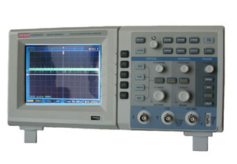

Oscilloscopes are common place in electronics workshops and laboratories. However they can be expensive and in a lot of cases they are bulky and more than is needed for the job in hand. Oscilloscopes also come in the form of storage scopes, which can record an output trace over a much longer period of time.

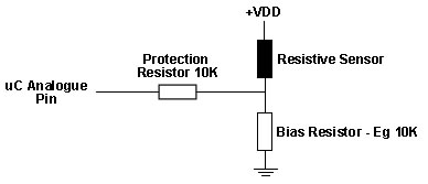

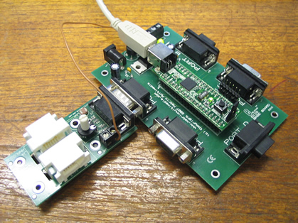

To provide the analogue sources I have connected an EB003 sensor board to Port A of the ECIO and used the onboard LDR and potentiometer. Alternatively you could connect the analogue inputs to just about anything to read the voltage. You may want to put a 10K series resistor between the analogue input pin and the analogue voltage source to avoid any potential damage to the ECIO microcontroller. Here is a good example circuit that will suit most types of analogue resistive sensor.

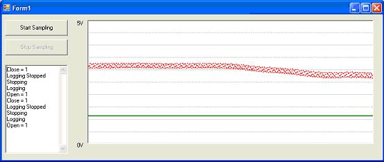

It is also good practise to add a ceramic capacitor between the analogue voltage source and ground to filter out any frequencies too high to be detected by the microcontroller. Here we can see the effects of a high frequency signal the output is aliased and instead of a nice single trace we seem to get multiple traces occurring simultaneously.

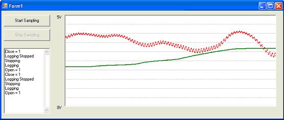

Here is a picture of the finished project. As you can see the two analogue traces are being plotted onto the screen, one in red and the other in green. The oscillations seen in the red line are from the LDR sensor picking up 50hz mains interference via the strip lights in the Matrix development office.
