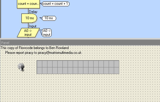

I was looking at your example and I noticed that in the panel this message was given:
I wasn't aware that Flowcode doesn't look at the owner of Flowcode but at the author of the program.
Am I in violation of piracy rules now :lol:

Re: Pulse Width Timing
Hi Eric
Ah yes sorry about that. The text is automatically added when creating a new program and I must have forgotten to remove it.
Maybe the message should be changed to "this file was created by" instead of "this copy of flowcode belongs to"

Ben, If it's a piracy thing, then the way flowcode 3 displayed the name on the main grey window was good.
Taking your point, there could be an editable field in options menu. Then whatever name is entered in this field will then be transferred to flowchart in the form of 'This file was created by: name here'
Would be better if name in this field is retained, unless you manually change it.
Alternatively the owner of the Flowcode always appears on the flowchart or control panel when it is opened or created, irrespective of the name of creator.
So If I loaded someone else’s Flowcode then my name would appear on the flowchart or control panel as the owner of Flowcode, but the creators name could appear as 'This file was created by: name here'
