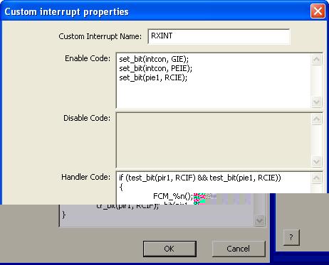

The RS232 has a built in interrupt that will tell you when you have received a byte.
Create a custom interrupt with the following settings.
Once you have done this you may also have to call the RS232 read macro at the start of your program to ensure that any errors are cleared from the system before allowing the interrupt to run.
Inside your interrupt macro you can use the RS232 read macro to collect the byte that caused the interrupt.

I have the ECIO28 and ECIO40 MCU with PICs. I try to write the custom interrupt. But on the hardware it does not work. I think there is a problem in the chip setting. Can you tell me whether I should have a special chip setting? What else I can do wrong? The other Interrupts work well. Perhaps you can me tell more...
Thank you
Michaek
Re: PIC18F4620 RS232 CUSTOM INT
Hello
Have you done this in your program?
You may also have to call the RS232 read macro at the start of your program to ensure that any errors are cleared from the system before allowing the interrupt to run.
If this doesnt allow the interrupt to work correctly then please can you attach your program to the forum and I will take a look for you.

Hi!
The Problem seems to be solved. But it only works if:
1. Before the interrupt is enabled the port must be read out.
2. The implemented RXINT does not work. It must be written as a customer interrupt:
enable code:
set_bit(intcon, GIE);
set_bit(intcon, PEIE);
set_bit(pie1, RCIE);
handler code:
if (test_bit(pir1, RCIF) && test_bit(pie1, RCIE))
cr_bit(pir1,RCIF);
FCM_%n();
Thank to the people of Matrix Multimedia for the nice help.
