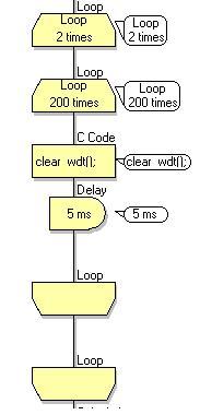

Benj wrote: Anyway have a bit of a play and let me know who you get on.
I have got round the auto clear watchdog issue by using delays like the one below:
Thanks again.
Auto Clear Watchdog Issue.JPG (11.78 KiB) Viewed 14439 times
Two second delay
Re: Auto clear watchdog problem
Hi Medelec,
Your right the watchdog shares the prescaler resource with timer 0 and not timer 1. The powerup timer uses timer 1 but this should not be active during operation.
Im a bit stumped by this. Thanks for posting up the workaround.
If I get some time I would like to have a look at the assembler code to see exactly what is going wrong with this.
