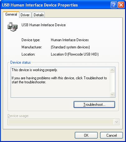

Ok I have tried the Flowcode program here on a MIAC and it correctly compiled and the MIAC then appeared on the PC as a USB Human Interface Device.
