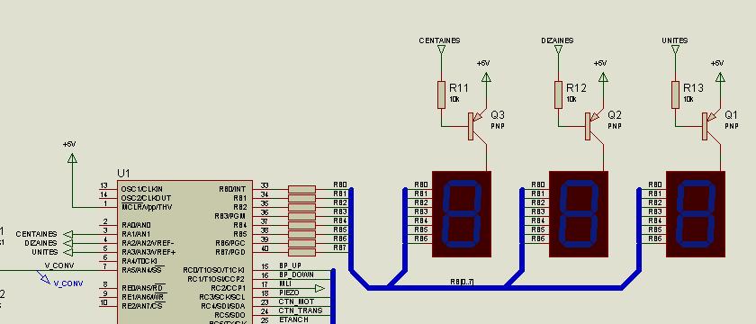

Step 1: To simplify things, I made a diagram in Isis and simulate (see image attached). it is a multiplexed display and simulation shows me that everything works the way I want.
Step 2: Programming Winpic -> OK

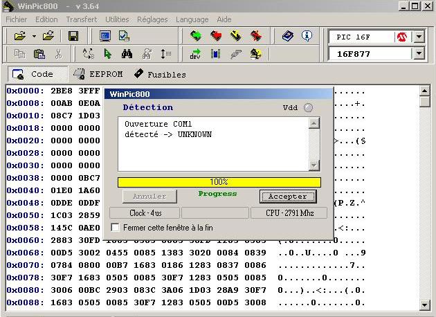

Step 3: Reading and access to my pic ---> Problem impossible to access and appearance of the message "UNKNOWN" instead of my pic "16F877", and there is drama, not read , write, erase ... pic is dead.
I put some in the Attachment screen printing as well as the source file.

- WINPIC800 VIEW
- wpinterpb.JPG (75.78 KiB) Viewed 5038 times
- ISIS VIEW
- isisinterpb.JPG (40.83 KiB) Viewed 5038 times
