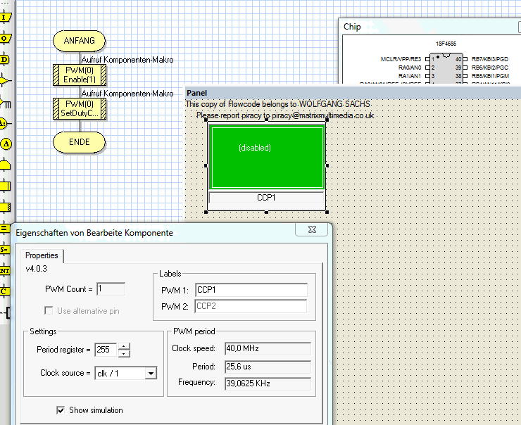

Hello Benj
I delete the 18F4685.fcd file and download new;
if i compile the code,only init > pwm(0)1 set cycle > pwm(0)1 i have the thame Error:

- pwm 4685.gif (30.78 KiB) Viewed 5806 times
Re: pwm on 18f4685
Woops sorry I left a define with the PWM channels still set to 2.
Here is a working FCD that should allow you to compile correctly.
- 18F4685.fcd
- (12.04 KiB) Downloaded 327 times
