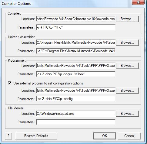

When i goto compile options i get some errors see attached pics
The way i installed the drivers may not be the problem it may just be my set up , If somebody can advise please

What you need to do is in 'Chip' 'compiler options' For the programmer, click Browse, and go into C:\Program Files\Matrix Multimedia\Flowcode V4\Tools\PPP (or what ever directory Flowcode in installed)
Click on the ppp exe file for both parts in programmer.
See attachment.

I was explaining step by step for any one who is new an don't know how two access options (in 'Chip' 'compiler options). To make it clearer here is what I have got for each section. You could use the browse button, or just copy and paste.
Compiler:
Location:C:\Program Files\Matrix Multimedia\Flowcode V4\BoostC\boostc.pic16.flowcode.exe
Parameters:-v -t PIC%p "%f.c"
Linker/Assembler:
Location:C:\Program Files\Matrix Multimedia\Flowcode V4\BoostC\boostlink.pic.exe
Parameters:-ld "C:\Program Files\Matrix Multimedia\Flowcode V4\BoostC\lib" libc.pic16.lib flowcode.pic16.lib rand.pic16.lib float.pic16.lib "%f.obj" -t PIC%p -d "%d" -p "%f"
Programmer:
Location:C:\Program Files\Matrix Multimedia\Flowcode V4\Tools\PPP\PPPv3.exe
Parameters:-cs 2 -chip PIC%p -nogui "%f.hex"
As you can see it is the [INSTALLDIR]TOOLS\PPP\PPPv3.exe that is wrong and it is the Browse next to that like you need to click on and manually loacate PPPv3.exe on your hard drive
Hope this helps

Hi medelec35
Sorry to be a right royal pain in the ass but still having problems
The following settings are in my flowcode
Compiler location :-
C:\Program Files (x86)\Matrix Multimedia\Flowcode V4\boostc\boostc.pic16.flowcode.exe
parameters :-
-v -t PIC%p "%f.c"
Linker / assembler
C:\Program Files (x86)\Matrix Multimedia\Flowcode V4\boostc\boostlink.pic.exe
parameters :-
-ld "C:\Program Files (x86)\Matrix Multimedia\Flowcode V4\BoostC\lib" libc.pic16.lib flowcode.pic16.lib rand.pic16.lib float.pic16.lib "%f.obj" -t PIC%p -d "%d" -p "%f"
Programmer
C:\Program Files (x86)\Matrix Multimedia\Flowcode V4\Tools\PPP\PPPv3.exe
parameters :-
use of external program to set config is ticked
location :-
parameters :-
-cs 2 -chip PIC%p -config
i am getting an error saying that cannot open file 887.c
and cannot ID the onboard chip ?
see sttached screen dumps
attached bellow is text file that flow code compiles .
Thats it for tonight before somthing goes through a window
steve
