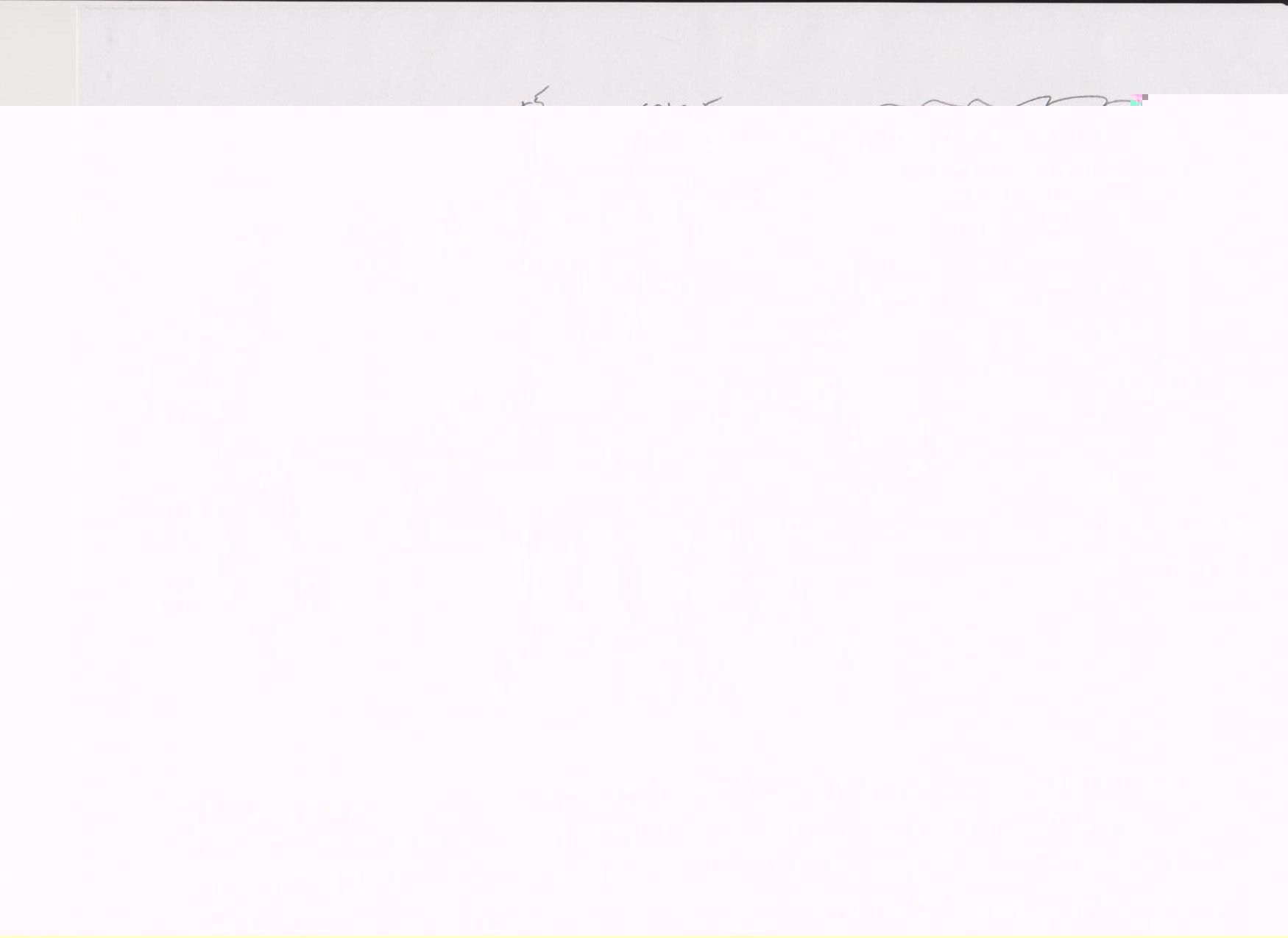

Re: ds1307
Daniel,
Thanks for the quick response
Please find the schematic attached - hopefully all is legible
I tried a dirrerent DS1307 and same result - I really want to get this working - thanks for your help !!
George
George
- (166.55 KiB) Downloaded 6375 times
- Dan81
- Posts: 268
- Joined: Sun Jan 15, 2006 4:07 pm
- Location: Albi France
- Been thanked: 60 times
Re: ds1307
Hello George
SQW/OUT needs a pull up.
But if bit CH is still at 1, there will be nothing on SQW.
- Take a look at SCL and SDA with an oscilloscope. (The idle state must be 1.)
If there is no aknowledge, the read value is 255 (and display 45 or 85) and you get 00
Did you modify the value of the init time (init_min ...) ?
good luck
Daniel
