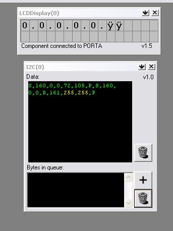

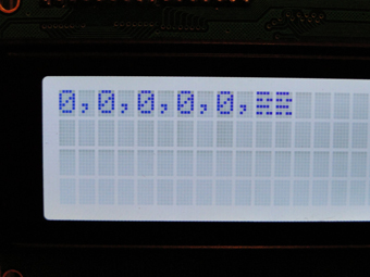

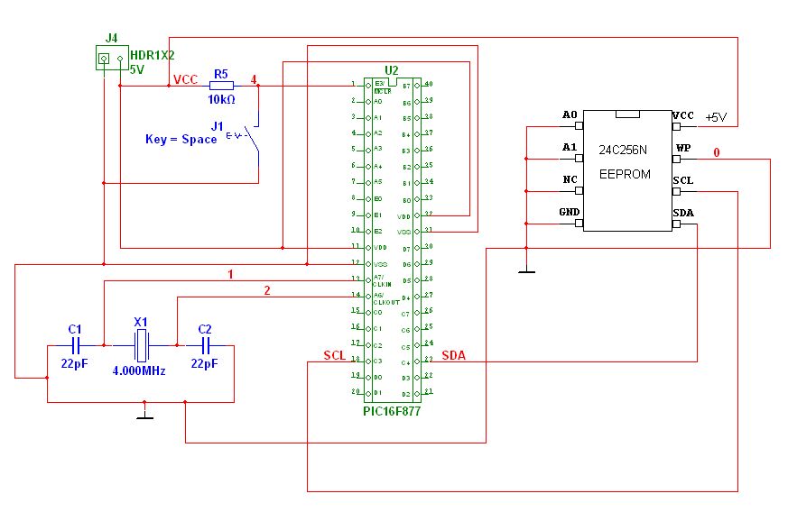

Thank you for responding so quickly. Here are pictures of mounting a PIC and EEPROM on the program Flowcode V3 with I2C.
Y there mistakes?
On my LCD it displays "0,0,0,0,0, **"
Note: * = bizare characters
thank you
Y there mistakes?
thank you

Yes! I misspoke when I did the diagram to show you my setup. Which were correct, WP to 0V (GND).
Problem: why my data instead of becoming 255.255 72.103 72pour which H i and 103 for either "Hi"? Flowcode in my LCD and two odd characters (see attached images)

In simulation you must giv the ee-prom value into the queue.

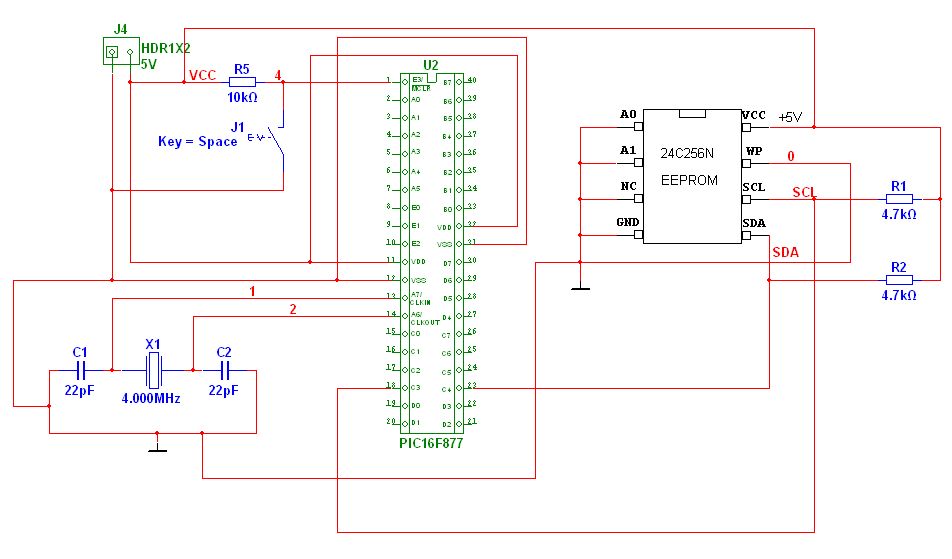

Lines SCL and SDA need pull up (4.7k), (they are not drawn on your schematic).
For debugging : Instead of using "Print Ascii" macro you can use "Print number"and see the received values.
Post your file, it will be easier for us to help you.
Daniel
Daniel

For Dan81 : I added the two resistors. It's just like here? see attachment PIC_EEPROM.jpg

queue = in german schlange....
If jou simulate write to the ee-prom , it do nothing real,only it show data in the " data window ".
The code read in the " queue window " ...if there are not data (you must input it ;click + ...) jou have a mitch match ...

yes,thee 2 windows simulate the ee-prom (correctly the data`s on the i2c bus)
For test your real hardware yu must connect at least led`s or better a lcd display.
Regards Wolfgang
Regards Wolfgang
Re: I2C for external EEPROM RESOLVED
After changing the port (port A to port B) Port B default because Flowcode outputs are real!
And after loading the SLC and SDA pins with resistors of 4.7 k everything works!
Thank you Thank you Thank you
