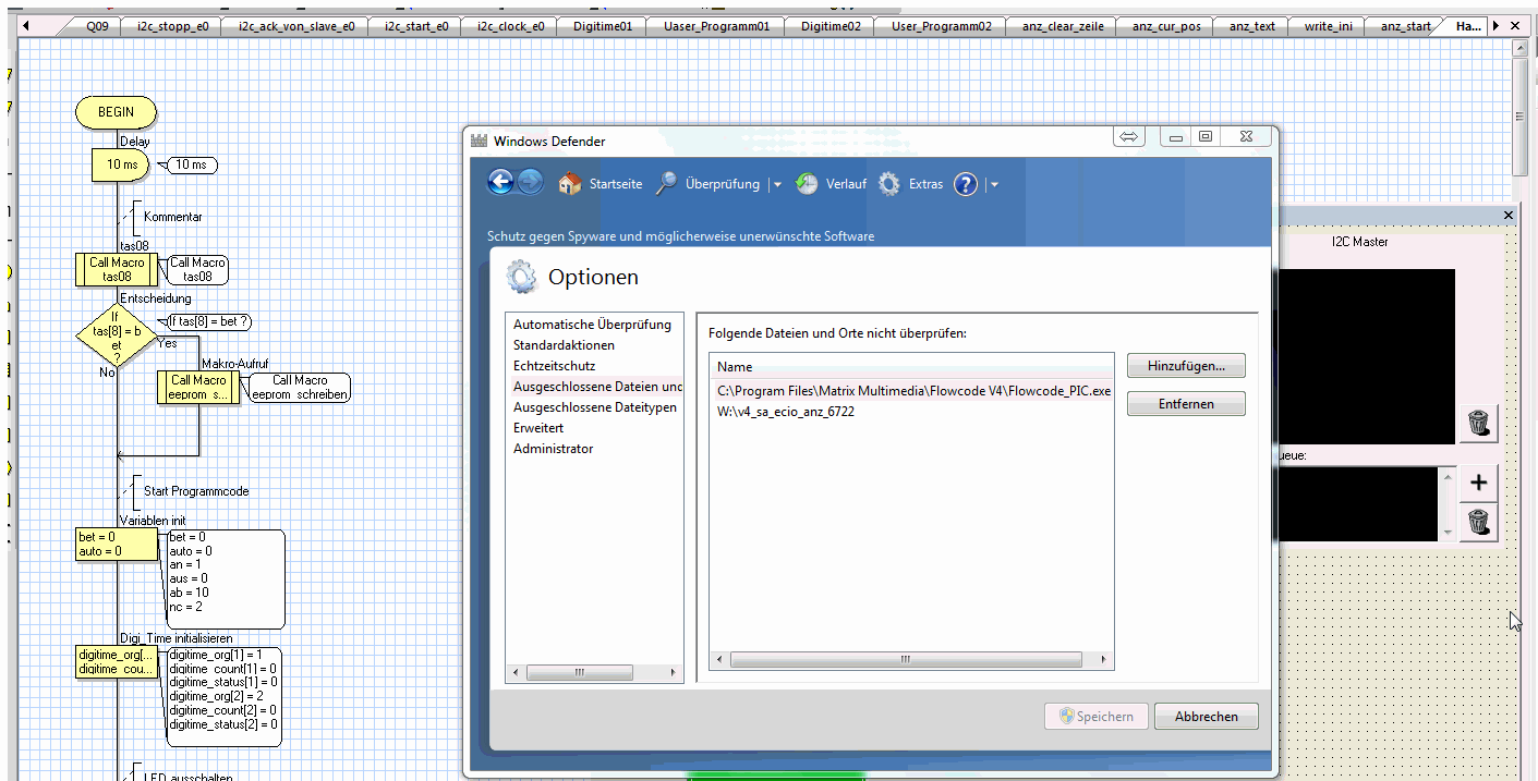

Do you mean the delay when first opening Flowcode? I did have this and I found that Windows Defender was the culprit. I fixed this by going into Windows Defender's options screen and adding the Flowcode exe to the list of files that are not scanned.

Yes,after i do these,openingtime remain by 30sec to 5sec with your mailed one......

(74.39 KiB) Downloaded 1740 times

Excellent - I'm glad it works for you too.
