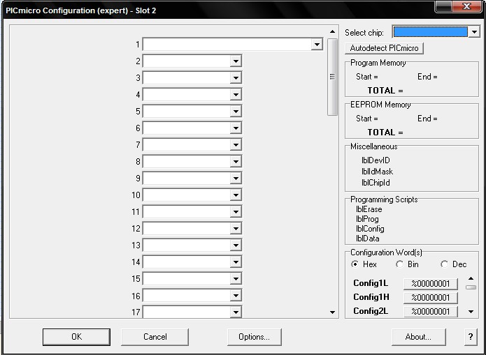

In the attachement, you can find the FCD I have on my computer but I think It's not the only problem.
I don't have anything in the Picmicro configuration box as you can see on the attached files.
Now, I have this error during compilation :

I use Flowcode 4.3.7.63, so the last one I think.

- 18F46J50.fcd
- (13.19 KiB) Downloaded 535 times
- ppp.jpg (64.32 KiB) Viewed 16054 times
Re: USB component and 18F46J50 family
I think this is a compiler issue. This device will currently only work with the HiTech compiler and not the default BoostC compiler.
Details of how to perform the switch are available from here.
http://www.matrixmultimedia.com/mmforum ... =26&t=6812
