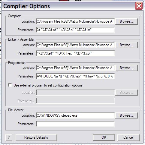

Simply swapping the first parameter in the programmer string (in the Chip -> Compiler Options -> Programmer -> Parameters menu) between AVRDUDE and STK500 should allow Flowcode to find the driver that has access to the AVRISPmkII programmer.

Not much luck, did as you have suggested, but used the drivers on the CDrom (required the 64 bit version), never the less I am still faced with this message on compiling to Hex...

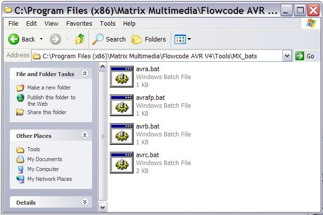

The batch file in question (avra.bat) should have been installed in the Tools\MX_bats folder of the Flowcode AVR V4 installation.The full path for your installation is displayed in the error message:
C:\Program Files (x86)\Matrix Multimedia\Flowcode AVR V4\Tools\MX_bats\avra.bat
Can you confirm that this file is in the correct location?

I've checked the Tools\MX_Bats folder 4 files avra, avrb, avrc & avrafp are all in there.
The flowcode 4 configure options are default.
The fsutil.exe behavior set disable8dot3 1 is active.
Unfortunatly still the same message as last post.
