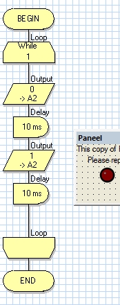

Dear Wolgang,
I have two remarks:
1) Perhaps better is to use a while statement instead of connection points, see picture.
2) Is there an output device? I tried the program with a LED connected to port A2 and it works fine
Look luck
Jan Lichtenbelt
I have two remarks:
Look luck
Jan Lichtenbelt

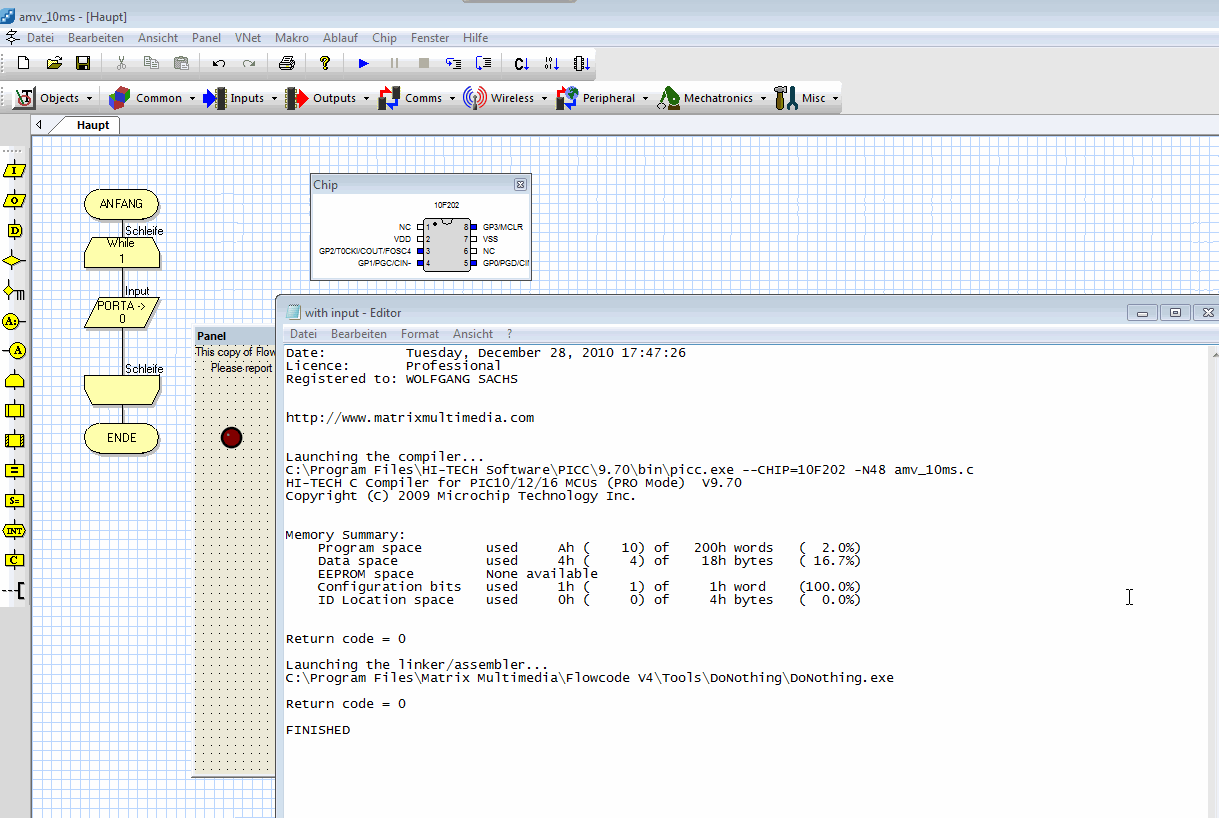

Re: pic 10f202
Hello Jan
With out 0x01 > pa ,in sumulation the led dos not flash.......0x04 is flashing......
but the same error
if i work without out-macro no error > compiler = ok...........
regards wolfgang
but the same error
regards wolfgang

Re: pic 10f202
Hello Jan
I have do these,with the v4.3.7.63 it work ok ; the open-time for a short code also ok.
But for big code these version is not ok.
Regards Wolfgang
Regards Wolfgang

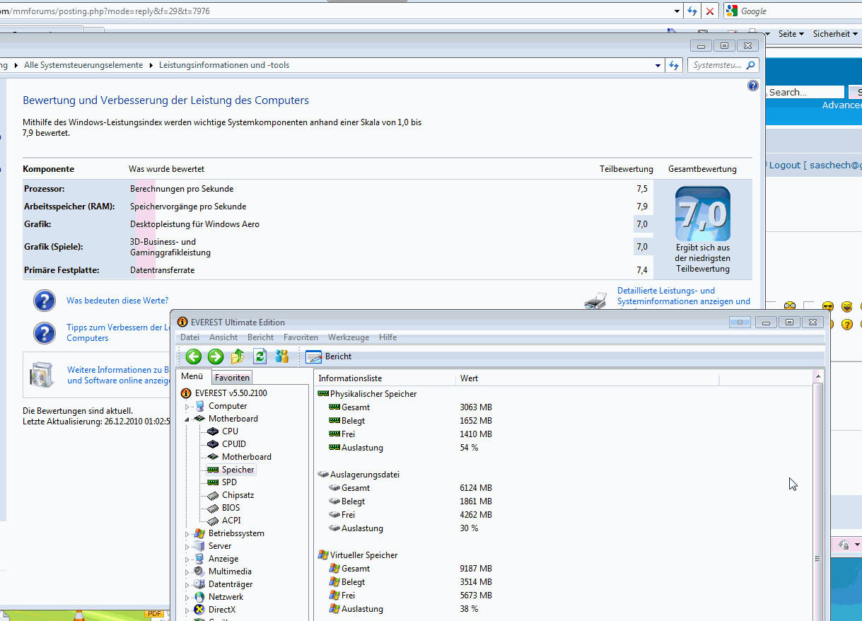

Re: pic 10f202
Dear Wolfgang,
The paralell communication shows to me that you probably have to less memory in your computer, which can declare the long program loading time.
Kind regards
Jan Lichtenbelt
Kind regards
Jan Lichtenbelt

Re: pic 10f202
Hello Jan
Without any kommentar
Regards Wolfgag
Regards Wolfgag

Re: pic 10f202
Dear Wolfgang,
1. SLow loading large Flowcode:
This was my last idee to help you. There seems enough memory. I do not know why the flowcode program loading takes minutes instead of seconds. Hopefully someone else can help you.
2. Pic 10f202 failure
I realise we deviate from the original problem. I tested it more in detail, but I also got an error during translation from C to asm. Here also I hope someone else can help you.
Good luck
Jan

Re: pic 10f202
Hello Benj
Ok compiling in flowcode and mplab-ide work : build ok
Thank`s
Regards Wolfgang
Thank`s
Regards Wolfgang
