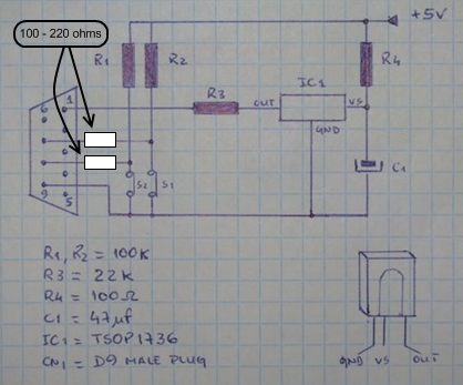

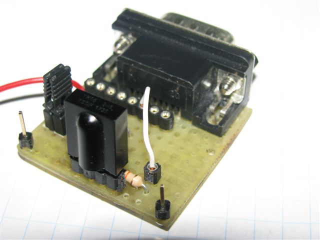

an exemple how to build ir receiver e-block:

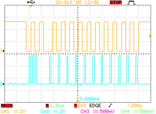

You can see in the picture below the signal coming from TSOP1736 (ch1) and the pulse generated by software on RE1 pin to show reading points (ch2).
It is key 0 in TV mode (address and command =0)

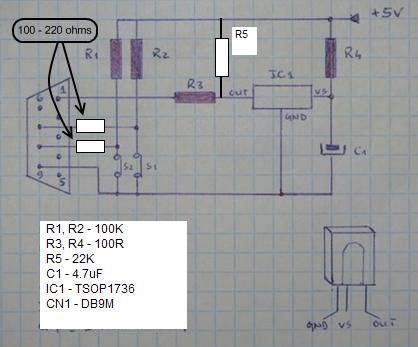

The IR e-block draw is wrong! It still works but the correct way is to connect 22K resistor to +5V.
Sorry…
Sorry…
