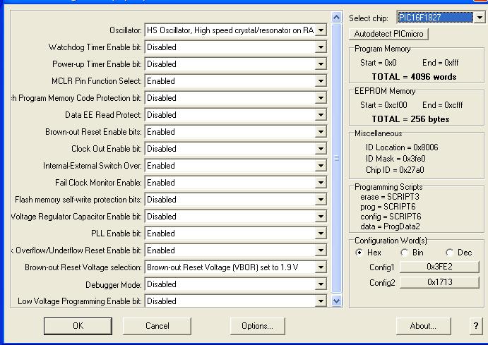

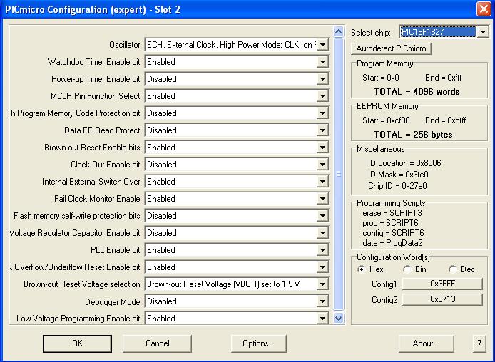

In IC - Konfiguration - switch to Expert config screen
expert
expert

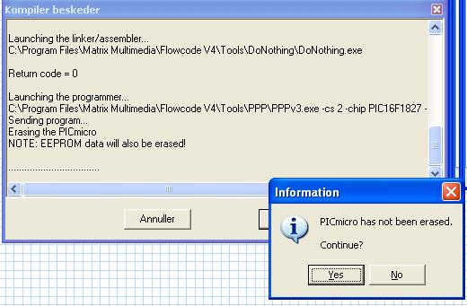

When I compile the IC I get the following message and nothing happened at IC?
(( there are no problems when I send the program to a pic16f88 ))

For 16F1827 you will need to set flowcode up for the hi-tec compiler. See:
http://www.matrixmultimedia.com/mmforum ... =26&t=6812
If left on boost C you will get
unknown identifier
and
invalid operand errors.
Aslo you will need to disable Watchdog timer, low voltage programming. Also you will need set configuration for the crystal you are using

Launching the programmer...
C:\Program Files\Matrix Multimedia\Flowcode V4\Tools\PPP\PPPv3.exe -cs 2 -chip PIC16F1827 -nogui "testmid.hex"
Sending program...
Erasing the PICmicro
NOTE: EEPROM data will also be erased!
Writing program memory
Writing configuration memory
Programming failed: <config2>
That took 1,891 seconds
Return code = 0

Hej Frank, tror jeg det må være!
Prøv lige i "Expert Config" og disable Brown out.
Jørgen

When I set up at led flasher and set a delay 1 sek so on time should be 1 sek the on time in realtime is about 275 mSek
That is because you have PLL enable ..enabled.
What that does is multiplies external or internal osc by 4.
So just disable that, and should work OK
