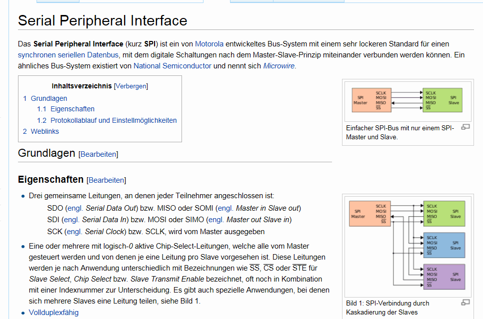

Hello Benj
I have a little confusion connect the spi bus:
The connections to your device will have to go like this.
CS - CS
SDO - SDI
SDI - SDO
SCK - SCKRegards
Ben Rowland
Matrix Multimedia
or
show the picture?
Regards Wolfgang
spi conn. 1.gif (50.6 KiB) Viewed 1764 times
spi conn..gif (23.53 KiB) Viewed 1765 times

MOSI (master out, slave in) refers to the output of the micro (i.e. SDO - serial data out) which connects to the SDI of the slave (SDI - serial data in).
So, they are both right. I hope this explains.
