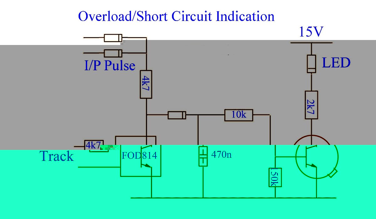

In the past 10-11 years a lot has changed in the world of electronics. Servos, Stepper Motors, Brush Less DC motors and Arduino computers etc.
I never completed my PWM project because of the difficulty of providing overload/short circuit protection for the L293/L298 H bridges. There is now another H bridge that solves this problem, a DRV8871 module. The modules are short circuit protected and have the over current limit set to 2A but this can increased to 3.6A by changing an on board resistor. They have a voltage range of 6.5V to 45V so this should be enough for almost all applications. The module is 20x24mm but is slightly more expensive than the L293/L298 H bridges but well worth it.
The DRV8871 modules only need 2 PWM input signals, forward and reverse, both low and the motor will free run, both high and the motor will brake, similar to the L293/L298 H bridges but without the third input terminal.
If there are not enough PWM outputs, an electronic changeover switch like a DG419 or NC75B3157 can be used to switch one PWM signal between the Module’s two inputs.
Short circuit/overload indication can be provided by a simple circuit that does not use any computer I/O, it is a shame that the module does not include this circuit. It works by comparing the input and output pulses, if there is a short/overload there will be no output pulse, so a light is turned on. The capacitor stops it flickering at low duty cycles. Built on to Vero board it is about 20x27mm.
PWM frequency should be in the range of 50-100Hz for the best results. The higher the frequency the more it is like DC and the advantages of a PWM drive is lost.
Happy programming to all.

Woode wrote:I never completed my PWM project because of the difficulty of providing overload/short circuit protection for the L293/L298 H bridges.
What I would do is choose a suitable resistor for current sense that will give a suitable voltage drop, when current limit reached.
The voltage across current sense resistor is fed into ADC.
Then when ADC goes above a preset value, PWM is changed to 0, until a reasonable time has elapsed or power is recycled.
