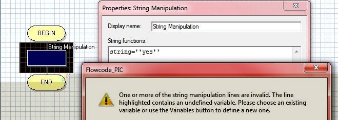

Thanks Ben,
About the string = ''yes''
I do this in the strring manipulation icon and does not accept it! It says that the line contains an undefined variable and means the ''yes''

Re: string if statement
OK, the problem was that the punctuation marks I used were created by the wrong key!
If you see in the first screenshot the space between the punctuation is bigger than the space in the second screenshot!
So if anybody else is having the same problem then it would be best to start looking for the right key! On my keyboard the right quotation marks is generated by shift+2.
Thank you.
Thank you.
