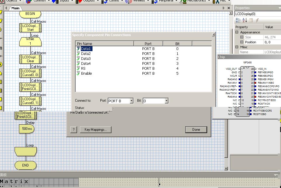

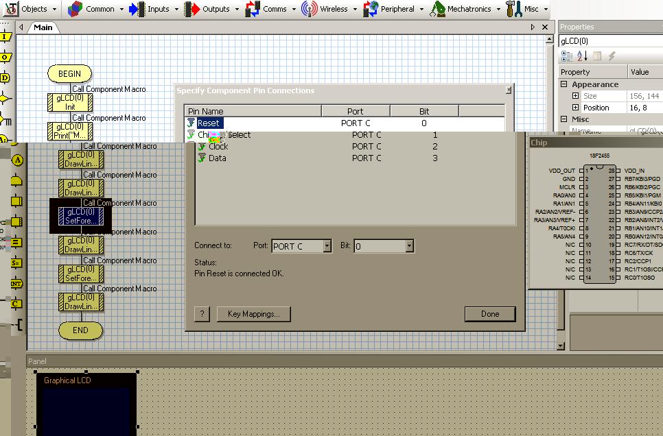

For both B/W and color LCD, I just use the downloaded testing program, and changed the chip as ECIO28P, and the port as below (and attached screen capture):
B/W LCD:
Data 1: PORT B bit 0
Data 2: PORT B bit 1
Data 3: PORT B bit 2
Data 4: PORT B bit 3
RS: PORT B bit 4
Enable: PORT B bit 5
For Hardware setting, I have cal. the contrast VR, but still obtain all black, but flashing or all "white" and flashing. Just like fully filled by dots. Voltage I use the power from the EB-061 application board 5V output.
Color LCD:
Reset: PORT C bit 0
Chip Select: PORT C bit 1
Clock: PORT C bit 2
Data: PORT C bit 3
For hardware jumper setting, I have tried all the config, but sill no any display at all.
Power is from the main power supply (14Vdc).
May I have your help?
Thanks so much.
Dick
B/W LCD:
RS: PORT B bit 4
Color LCD:
Reset: PORT C bit 0
Clock: PORT C bit 2
Data: PORT C bit 3
Thanks so much.
Dick
Benj wrote:Hello,
Please could you post up your program and I will have a look for you. Could be that the configuration settings do not match your hardware or your clock speed is incorrect in the project options window.
- Color LCD flow chart and connection
- connection.JPG (145.35 KiB) Viewed 5874 times
- B/W LCD flow chart and connection
- connection.JPG (131.22 KiB) Viewed 5874 times
