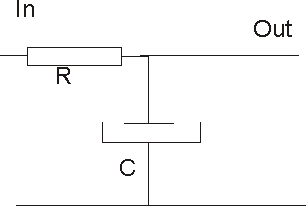

Dear Jorgen,
An other way of measuring the on duty time is by integration the input signal. And then digitalise the input by means of ADC.
Integration is very easy. Just a RC circuit. However, the disadvantage of this method is that the RC-time must be about 10 times the period time of the input signal. If that is not a problem, than you can use this method.
Succes,
Jan Lichtenbelt
Succes,
Jan Lichtenbelt
