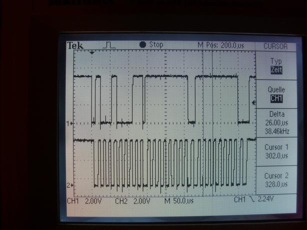

Then I want to use the Flowcode routines “Start I2C “, “Transmit”, ”Read1”, ”Read2”, ”Stop” every second to read the temperature and then sometimes the RXINT seems to be done but there is no or a wrong value in the Rxread-component value what is given back. (This occours various times in a minute).
I checked the hardware
=> RS485 working over day => seems ok
=> I2C Pullups 4K7 an the picture seems ok to and the LM75 is working.
Is there a relationship between the both things. I don´t know how to solve this. I spend days to find out whats going on there. The I2C Signals are 72,57Khz (slowest).

I2C scope screenshot
