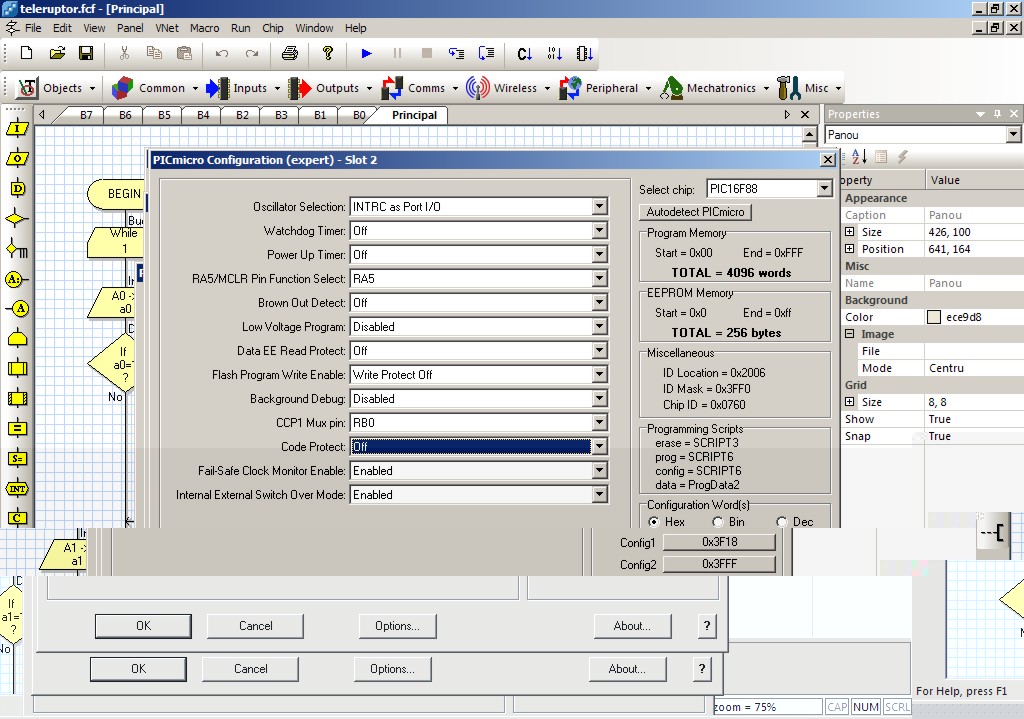

Hello everyone!I'm working on a project for my house.I have to build a board with 8 latching relays witch command 8 lights to my house... relays are controlled from several points in my house.I chose for this project 16F88 because i have one of these. The problem is that I need 16 I/O and to make room for all 16 I/o, I have to use the internal osc. and no MCLR.I simulated the program in Flowcode and it work well but when I upload the Hex into MCU something is wrong. I upload here the file for flowcode 4. I need help for configuration when I comiple the cip. The last configuration is in the attachment

The reason your project is not working is because the default frequency for internal osc is 31.25 KHz
If you want to run internal osc at a different frequency then you will need to add a C code box at the beginning of your program with an osccon value within it.
E.g for 8MHz
osccon=0x70;
for 4MHz:
osccon=0x60;
I have modified your flowchart to run at 8MHz.
Can you please let me know if flowchart works OK for you.
Thanks.

Sorry modelec35 but it did not work either with the C code box added. I still have the same problem. The configuration words that I`m using are: Config1 0x3F18 and Config2 0x3FFC. Where I`m wrong?

What is the problem you are experiencing?
I believe only problem I can see is ports staying on once activated. That is because the code is activated so fast after switch is released it would be always read as 0 and not what the flowcode simulator shows. I could be wrong. Not got time to test. If no one else answers I will test a bit later.
Is this the problem, or ports not activated at all?
Have you toggled a pin at 1Hz to see if configuration is correct?
Config settings look fine to me.
