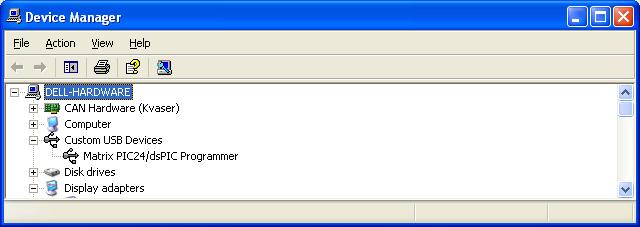

Sounds like the USB driver may not be installed. Is it listed in the windows device manager under the USB section or the custom section.
Also if you have the mLoader software running, the device connected and the driver installed then it should look like this.
The driver installer can be found here listed as "EB064 USB Driver".

mloader is red and say's no device detected.
have re-installed the driver numerous times, hardware/custom usb devices reports device is installed and working properly
