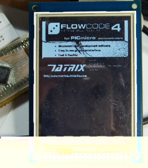

Pic18f4550 and Flowcode4 Flowcode5 and works perfectly with your program.
How could a "bmp" image displayed on the SSD1289?
Thanks for the help so far!

For a bitmap you could store the data into the program memory on a byte by byte basis if you have enough memory available to do this.
Other alternative methods are to stream the data in eg via a serial connection from a VB program running on a PC and maybe store the data into an external EEPROM device so you can use it later.
Another option may be to stream the data from a SD card or other memory device.

Dealt with the little screen.
Flowcode5 was made. Unfortunately, the huge size of the program.
Resolution:240*160 color depth:1bit.
