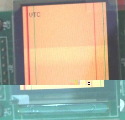

dickcheung
- Posts: 10
- Joined: Sun Jun 26, 2011 4:19 pm
Re: gLCD with Formula Flowcode
Hi Benj,
Thanks for your great suggestions, I am currently tried to use the gLCD (EB0058) to my ECIO (28P), per your below description, I set my gLCD to:
- (a.)patch, port B, s/w mode, (b) B, port B, s/w mode, both settings are work.
- CS as bit 0.
- in flowcode, the properties set to EB0057 as no selection for EB0058
- CS as bit 0.
It works but I found some red/green/black vertical lines shown on the left and right side of the screen (attached) which I am not desired to obtain this, why this happened? am I set wrong in properties? I set it as EB0057 (my gLCD is EB0058-00-1. I tried to set 43v2, but no luck.
Besides, I tried to set the background but always keep unchanged (yellow) no matter I set in gLCD properties as customize or not.
Thanks for help.
Dick
