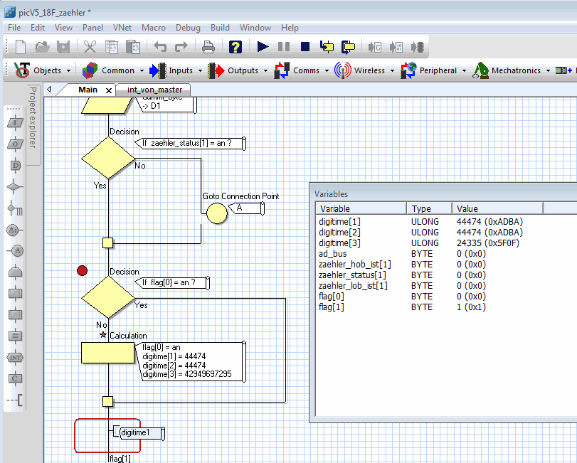

I have trouble with the ULONG variable.
I expect 42949697295 >> I show 24335??
Please help

The problem is that a ULONG is a 32-bit number. 42949697295 is hex A00005F0F - in 32 bits this is 00005F0F (the 'A' is lost in integer overflow).
For the hex number A0005F0F use the decimal 2684378895.

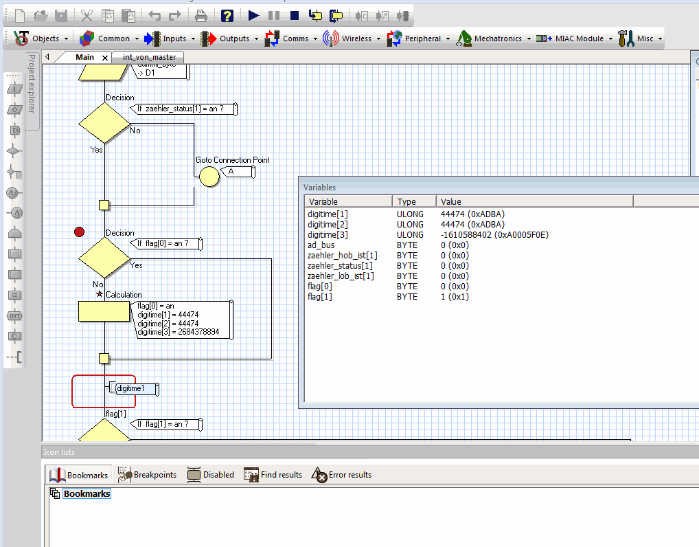

Hello Jonny
I think the information in the build-window are not right.
If I put in your new number show......
Regards Wolfgang
(49.26 KiB) Downloaded 658 times
(63.72 KiB) Downloaded 658 times

Hi Wolfgang. Yes, there is an issue where unsigned values are shown as signed in the watch window. The value is correct, it is just the signed equivalent. The hex value is always unsigned.
