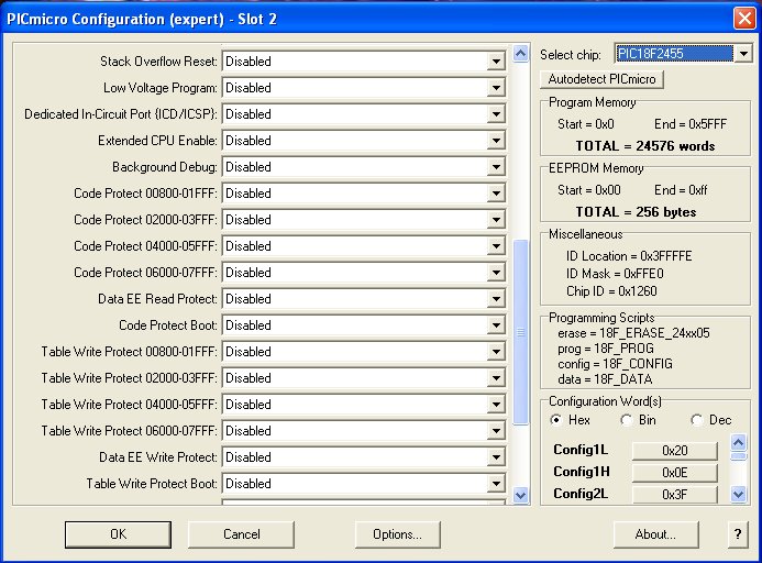

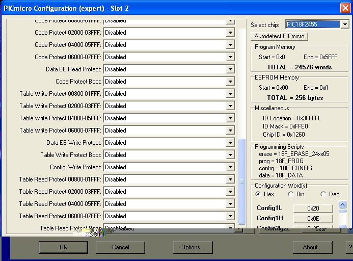

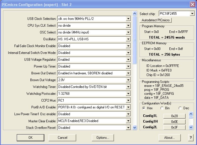

Re: Why not:Flowcode USB serial -Detailed process
Post by Gary Freegard »
Hello
From looking at the program the issue is the configuration of the PIC.
The required information is on page 3 of the link that Ben sent, and I have attached 3 images of the config that I use.
This is for a 18F2455 which is the 28pin version of the 18F4550.
Good luck
