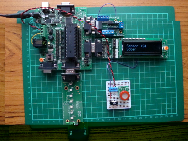

Equipment:
EB006 Programmer Board with 16F877A
EB005 – LCD Display – Port B
EB002 Screw Terminal Board – Port A

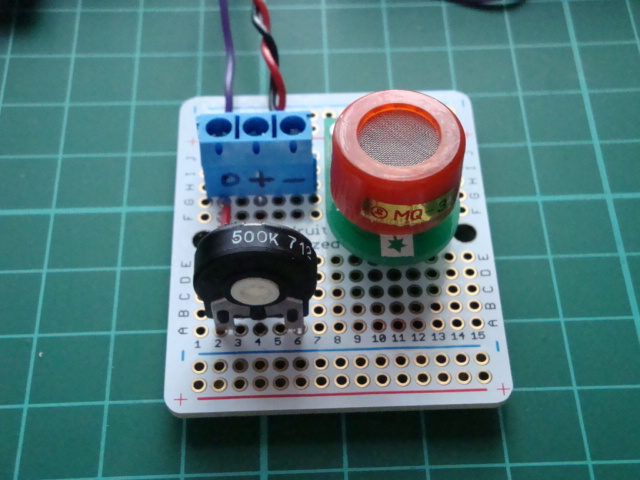

MQ3 Board:
The sensor is mounted on a Pololu break-out-board, as the sensor has an unusual pin out.
This is mounted on an adafruit ¼ size breadboard along with a 3way screw terminal and the 500k pot.

The LCD Display shows on the
Topline = ADC value
Bottom Line = The status of the person being tested.
Port C is used to control the LED e-block to give a bar graph type display of the level.
Calibration is done by means of a 500k-ohm trimmer.

Setting Up & Testing:
I initially tested the circuit by soaking a piece of absorbent paper in Isopropyl Alcohol and held it above the sensor and blew gently on it so the vapour went towards the sensor.
(Don’t let the liquid get onto the surface of the sensor).
This will allow the unit to give out the full range of values.
For real world testing, I have set to a sensor reading of 20 in fresh air.
After a pint of 4.8% bitter blowing on to the sensor gives a reading of about 270.
This is probably a falsely high reading due to excess mouth alcohol.
The output of the unit does tend to increase slightly when blown on even if no alcohol has been consumed. This could possibly be down to the presence natural alcohols.
Several examples of the use of this sensor can be found on the internet / you-tube.
The red & black wires are the 5V power to the sensor. Draws approx 150mA
The purple wire is the sensor output. Goes to ADC0
