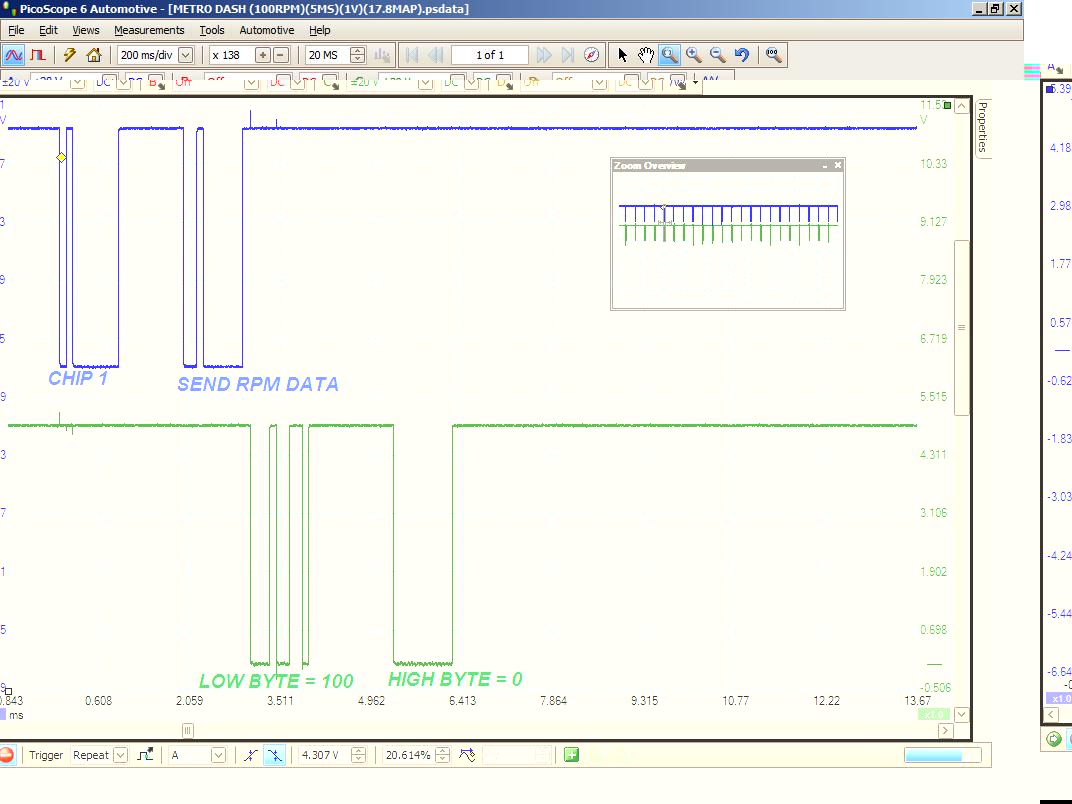

picoscope waveform of master commanding chip#1 to send rpm data...followed by chip#1 sending data as 100hz
(119.48 KiB) Downloaded 2554 times
