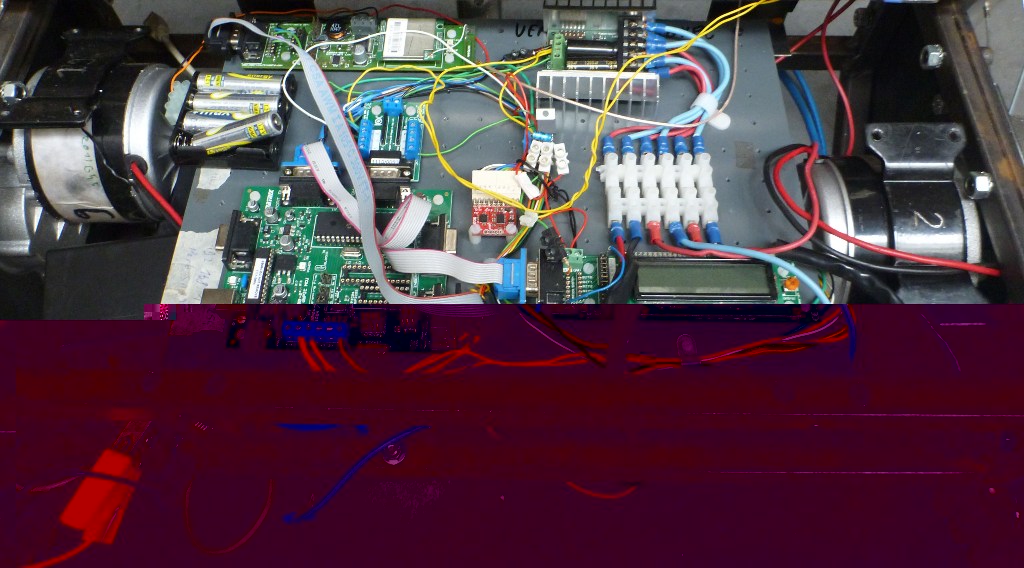

Re: Segway like véhicle with Flowcode DSpic
Post by benp »
If you want to see the E-Blocks inside.
This picture is during test before painting...
