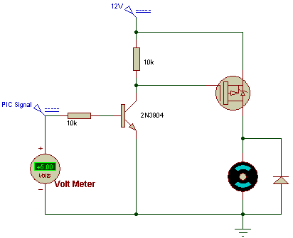

You can use this kind of driving circuit with NPN transistor base is pull down by 10K..I also read about P channel fets, but i get a bit confused what would be needed to drive a P channel fet.
- Driving_P-Channel_MOSFET.gif (7.27 KiB) Viewed 15528 times

Thanks,
This looks fairly simple.
Could I use any N channel transistor for this, like a bc337 or a bc 547?

Actually NPN transistor will ON only when you want to turn P-channel MOSFET On, so NPN will be kept OFF most of the time..that's why 10K is pretty OK. But to have more protection you can go for something like this..Would you add Addtional components to protect the circuit?
I see the pull up resistor is 10K could I go even higher so to save battery since this one has to pull power all the time.
- (26.13 KiB) Downloaded 9840 times

Thanks this is explaining it nicely.
Just one question R3 forms a voltage divider.
Is it correct that this one can be left out if the supply voltage is 12 Volt?

Actually R3 is gate current limit and D1 is to protect surge in VDG..Just one question R3 forms a voltage divider.
